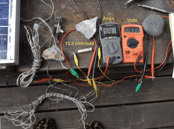

Ignore numbers on meters above. Borrowed pic off YouTube.
1. Hooked up as above without the volt measurement. Measured 0.02amps.
2. Hooked up from solar panel as follows. Positive wire from panel into charge controller. Negative wire of panel to red terminal of multimeter. Black of multimeter into negative of charge controller. Measured -0.02amps.
Voltage of panel showing about 19v. Voltage at charge controller terminals for panel and battery 11.8.

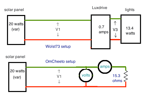

I still don't see where we've done measurements for the following configuration:
And with the new ammeter, we could figure out the efficiency of the Luxdrive.
