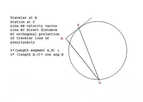

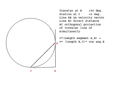

Austin0 said:
But using the previous parameters circle C=314 ls in station frame. v close to c then:
At 90 deg. Calculated time at station is 28.5 sec.
180 deg. 157sec.
270 deg. 285.5 sec.
Austin0 said:
CADO_H is simply the coordinate time at the location (in the station frame in this case)
SO at 90deg. the local time is 78.5
L is the distance in the station coordinates
so at 90deg.the velocity vector would orthogonally intersect the position of the station observer (the tangent at the station point) so the distance in the station frame would be equal to the radius 50 ls ...multiplied by v =approx 50 sec this is just the lorentz math for determining relative clock desynchronization.between frames.
subtracting this from 78.5 gives CADO_T=28.5 ..the calculated simultaneous time at the station.

It appears to me that in the case at 90 deg. that I used,, the cos (45deg)=.707 times the direct distance (70.7 )does equal the radius. SO in that particular instance there is agreement.
But I am not sure if this is true all around the circumference
This a drawing of a further point: is my approach of orthogonal projection equivalent to the dot product?
Looking at your graph it looks like my result is very close to yours for 90 deg. estimating values for a quarter of the circuit from your chart.
How do you get attached images to show up full size??
  • #281
Austin0 said:
I want to find out if the approach I used is valid or not and if it is equivalent to the dot product method. I am now thinking it is equivalent but want to make sure.d
Yes, I believe so.
