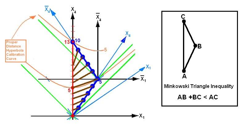

bobc2, there are many different ways to interpret the twin paradox. You seem to think that there is something I "don't get", but you are mistaken. You can choose to dismiss the acceleration involved but the fact remains that it is the acceleration which allows for what you're referring to as a shortcut through 4D space. I challenge you to find a twin paradox experiment wherein the younger twin, after they meet back together, has accelerated less than the older twin.
Also, you shouldn't reference "triangle inequalities" when you're discussing 4D time lines, as they are precisely the opposite of what you're pointing out. The LONGER the line in Minkowski light cone time line diagrams, the SHORTER the proper time.

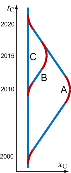

If both twins accelerate, it is quite possible that the one that accelerated "less" (less proper time spent acceleration, smaller value of G-force during acceleration) will have aged less, it just depends on the paths. For example, look at this spacetime diagram posted by DrGreg a while ago, in which twins A and B both spend exactly the same amount of time accelerating and with the same magnitude of acceleration, but because A spent more time between accelerations, B's path is closer to that of the inertial twin C and thus A will have aged significantly less:
It would be a simple matter to modify this diagram so that A's accelerations were slightly less than B's, and so A's velocities relative to C during the inertial phases of the trip were slightly smaller, but where A still aged less than either B or C.
Yes, that's because the proper time involves a subtraction, i.e. \sqrt{dt^2 - dx^2}, whereas distance in space involved adding the two coordinates, i.e. \sqrt{dy^2 + dx^2}. Still there is a pretty perfect one-to-one mapping between statements about distances along paths through space and statements about proper times along paths through spacetime, so they can be considered very closely analogous even if a few signs are changed, I discussed the details of the analogy in [post=2972720]this post[/post].

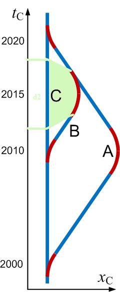

  • #155
I don't understand why you would say that. My diagram as well as the inequality statements for distance along world lines and proper times showed exactly what you are saying they did not show: The longer lines in the diagram (AB + BC) correspond to shorter Minkowski metric distances and also shorter proper times (AB/c + BC/c) than the shorter line on the diagram (AC).
Again, the triangular inequality is (AB + AC) is less than (AC)
or, (AB+AC) < AC

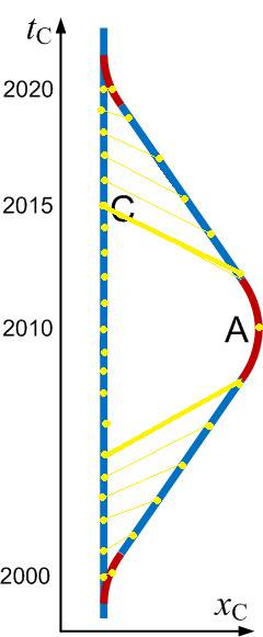

  • #156
Excellent point, JesseM.
  • #157
My point was that the phrase "http://en.wikipedia.org/wiki/Triangle_inequality" " has a distinct meaning in geometry which directly contradicts what you're saying. I've never heard of that term used in the context of proper time line charting, but it's not really pertinent one way or the other as I was not disputing your math.
JesseM, that graph clearly shows I misspoke and I thank you for it! If I may use it to further my original point (ignoring the initial and final accelerations for simplicity), charting the lines of simultaneity from the travelers' perspectives on their journey will reflect legs of reciprocity before and after their periods of acceleration.
It is only DURING their periods of acceleration that this reciprocity is broken. The sections I've labeled d1 and d2 show the sections of the graphs that encompass the differential. If we were to remove these sections the world lines of A and C, or B and C, respectively, would be of equal length. My point is that it is the acceleration which causes the aging differential. Your very valid supplemental point was that the timing of that acceleration determines the extent of the effect, and viewing the effect on this graph makes it very obvious why -- the further out on the graph the acceleration occurs, the longer the "d" segment will be on C's world line.

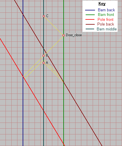

In my earlier analysis of the barn and pole scenario one of my conclusions was incorrect, so just for the record I'm posting a correction.
It seems there is an observer, in the middle of the barn who will see the pole completely contained in the barn, contrary to my assertion otherwise.
In the space-time diagram attached, the observer in the middle of the barn sees 1) the back of the pole enter the barn, 2) the front of the pole going past the back of the barn, 3) the door closing.
So, at any time between events A and B, this observer will see the pole inside the barn. We can conclude that whether the pole is seen to be in the barn is frame dependent, as JesseM pointed out some time ago.
Well, I have to work these things out for myself ...
Thanks to DaleSpam for pointing this out, and to PAllen for a PM response.

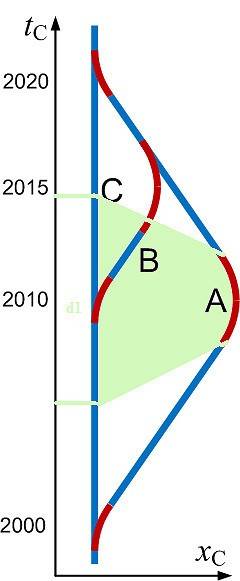

  • #159
But in what sense are those "lines of simultaneity from the traveler's perspective"? The traveler is a non-inertial observer, so if you want to talk about their "perspective" you have to construct a non-inertial frame for them. And as I said to GrayGhost, you can construct a non-inertial frame which has the property that its definition of simultaneity at any point on the traveler's worldline matches that of the traveler's instantaneous inertial rest frame at that point, that is not the only type of non-inertial frame you could construct for the traveler, and there are no "preferred" non-inertial frames in relativity.
What do you mean by "remove those sections"? If you calculate the proper time only along the blue inertial sections of A's worldline, leaving out the proper time along the red accelerating sections, the sum is still going to be considerably less than the proper time along C's worldline.
"Causes" is a little ambiguous. Again I would make an analogy with geometry--if we have two paths in space between points P1 and P2, and one path is a straight line with constant slope (relative to some cartesian coordinate system) while the other has a bend in it (changing slope), then since a straight line is the shortest distance between two points it is guaranteed that the path which had the segment with changing slope will have a greater overall length. Would you say in this case that the segment with changing slope "caused" the distance differential, even if the bent path consisted of two long straight segments with a very short bent segment joining them, like a "V" with a slightly rounded bottom? Obviously in this case most of the extra length of the bent path is on the straight segments which each have constant slope, not the curved segment with a changing slope, but it is true that the bent segment is what allows the straight segments to go in different directions and thus have a greater length than the other path which goes straight from P1 to P2. So if you would describe the bent segment as having "caused" the distance differential here, I have no problem with your using the same language in the twin paradox; but if you wouldn't, then I don't think you should in the twin paradox either, since as I explain at length in [post=2972720]this post[/post] I think the two situations are perfectly analogous.

JesseM, I've changed the graphic a bit to hopefully help make my point. Below are the world lines of twins in the "twins paradox" (it's basically just the graphic you provided with the B participant removed). I've added "clock ticks" on each time line, corresponding to approximately 1 year each. Twin C ages 21 years in this scenario and Twin A ages 13.
Now when I ineloquently said
I was referring to the length of each observer's proper time line, NOT the geometrical length of their time line on the graph. Viewing the twin's paradox in this manner, and removing the section associated with A's acceleration, both twins would have aged 11 years. My point is that this, to me, implies that the age differential is due to the acceleration of twin A. Does that help?
  • #169
But if the yellow dots are supposed to be clock ticks which are an equal amount of proper time apart for both twins, then this diagram is just wrong, successive clock ticks of each twin would not be simultaneous in the traveling twin's frame when he is moving inertially. In the traveling twin's frame while moving inertially, the Earth twin is moving at relativistic speed, so the Earth twin's clock is running slow due to time dilation--for example if their relative speed is 0.6c, then if you pick two events which occur one year apart for the traveling twin and draw lines of simultaneity in the traveling twin's frame, the points where these lines of simultaneity intersect the Earth twin's worldline will only be 0.8 years apart for the Earth twin.
That doesn't work though, even if you remove the section of C's worldline that is "associated with A's acceleration" (i.e. remove all points on C's worldline between where the two thick yellow lines intersect it), the proper time on the remainder of C's worldline would not add up to the proper time along the blue segments of A's worldline, in fact it would be significantly less than the proper time along the blue segments of A's worldline.
  • #170

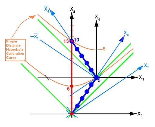

rjbeery, JesseM is certainly correct. You're sketch really doesn't demonstrate the situation correctly. You have not shown the proper time markers on each observer's world line. Consider using the hyperbolic calibration curves for the traveling twin; only then will you see the actual comparison of metric distance traveled (and proper times lapsed). I don't have time right at the moment to work up the sketches but will get back to it if you haven't had a chance to work them up.
  • #171

  • #172
rjbeery said:
As far as the "lines of simultaneity" go, there are a many ways to calculate them (e.g. from C's perspective, from A's perspective, using only what is observed, using Einstein's method, correcting for Doppler, correcting for Doppler and SR...). I've chosen to draw them from a hyper-privileged perspective such that a tick on each twin's clock has a one-to-one correspondence with the other. In other words, they have been corrected for ALL effects including time of light travel. My contention is that these are areas of reciprocal time passage, and that the area between the thick yellow lines contains a break in symmetry due to the acceleration of Twin A.
OK, I assumed they were supposed to be from A's instantaneous inertial frame, but it sounds like you were actually drawing them from two frames (different on the outbound voyage and the inbound voyage) where A and C were moving with equal speeds in opposite directions (away from each other on the outbound voyage, towards each other on the inbound one), in which case both clocks would tick at equal rates in this frame. But hopefully you'd agree that these aren't areas of "reciprocal time passage" in any objective sense, that the rates are only equal in this one frame?
  • #173
Yes, it's a arbitrary analysis but aren't they all?. I could just as easily continue to draw the one-to-one correspondence through the area of acceleration and be left with an age differential at the end of Twin A's trip but it wouldn't be illustrative of much; I'm just explaining how I think about the problem. This method visually accounts for age differentials of the Twins involved in any amount of acceleration by either one of them.
In the end can we "really" say that acceleration causes the age differential? Probably not. It's a bit subjective, really. But the fact that the age differential cannot exist without a frame change due to acceleration is sound enough logic for me to make that claim.
  • #174
rjbeery said:
I'm not sure how you can make that statement if the velocities and acceleration rates involved have not even been given! Are you both suggesting that the "clock ticks" would not look something like I have illustrated? If you do your sketches I believe you will find that what I've done is accurate.
Our sketches don't seem to look the same, rjbeery. My hyperbolic calibration curve is not precise, but is still good enough to communicate the concept we are talking about. I've marked off proper time intervals for each of the twins. Each observer moves along his world line at the speed of light.
Don't worry about the turnaround. I can have the twin travel as far out into the galaxies as needed to make the point. Of course that's why his view of the stay-at-home twin changes so rapidly during the turnaround. But my focus is on the proper times and distances. The traveling twin indeed takes a shortcut through spacetime. And be sure to start a new origin with a new hyperbolic calibration curve from which to measure proper distances when the twin changes directions.
By the way, you can find a comparison of the Euclidean triangle inequality to the Minkowski triangle inequality on page 256 of Penrose's "The Emperor's New Mind" (paper back).
  • #175
They are the same, or rather they show the same thing. Draw a line from each twin's proper time intervals (1 to 1, 2 to 2, 3 to 3, 4 to 4, and 5 to 5), up to the point of turn-around. Now do the same moving backwards from their reunion (12 to 9, 11 to 8, 10 to 7, 9 to 6, and 8 to 5). What you have outlined is a triangled area that represents the break in symmetry. The static twin's triangle segment is 3 time interval units long, representing exactly the age differential between the two twins upon their reunion. The same conclusion can be drawn from both of our sketches.
That's actually one of my favorite physic's books! Anyway I didn't mean to nitpick but you said "remember the triangle inequality" and I was just pointing out that the unqualified phrase is associated with "Euclidean triangle inequality", or the precise opposite of what you intended.
  • #176
O.K. Below I followed your instructions for connecting the proper times for the outgoing trip. However, your instructions for the second half of the trip did not make sense (why would you arbitrarily put a proper time gap in the middle?), so I have continued with the proper time sequence of connecting the corresponding times, which leaves the proper time gap at the end instead of the middle. By the way, the lines connecting proper times are not the same as lines corresponding to the sequence of blue X1 coordinates (which is what you have probably been trying to use).
But why the worry about gaps? Let's just show the mapping of the proper times onto the spacetime manifold and quit trying to read some kind of causal effect into the gaps? I could have a lot more to say about the proper time "gap" in my plot below, but we better not go there at this point.
Good. So, I guess we agree on the Minkowski inequality. Thus, we have the traveling twin in the example above taking the 10 unit shortcut through 4-dimensional space as compared to the stay-at-home twin traveling the 13 units (I don't care whether you regard them as proper time differentials or proper distance differentials).

I fully understand the sequence of cross-section views of the 4-D universe for the blue twin (in my diagram). I full understand that his continuous sequence of cross-sections of the universe change rapidly as he follows the curved path along his world line (corresponding to deceleration and then acceleration) in turning to take the short cut back to the red twin. I'm trying to illustrate something more fundamental than the blue guy watching the sequence of views of the red guy fly by as he (blue guy) rotates his view (faster than the speed of light if we set up a short proper path length going around the 4-D curve segment). It is no more significant than you observing a laser beam sweep across the face of the moon faster than the speed of light just because you can rotate your laser device sitting here on the Earth pointing the beam at the moon on a dark night).
I've got to figure out some way of communicating to you the more fundamental aspect of the situation--that we have two different world line paths followed by the twins--one is a shorter path than the other. If you simply think of these twins as 4-dimensional objects, their long length strung out for millions of miles along their respective 4th dimensions, then the question is manifestly, which object is longer (being careful to remember the Minkowski Triangle Inequality). Surely you would see this as objectively more fundamental than talking about how fast the light beam (blue's view) sweeps across the middle gap (sure, I've never argued there was not what you call a "gap").
After your last post I thought you had grasped the significance of the Minkowski Triangle Inequality that I referenced in Penrose's book. But, that doesn't seem to have any affect on your view of the twin paradox problem. How do you account for the Minkowski Triangle inequality in this example?

So, I guess in that sense you could say that the blue car in the race against red below will win the race because he induced centripetal acceleration in turning onto the short cut to win the race.
"If the red and blue cars always travel the same speed along their direction of motion, I challenge you to find an example where any car could beat the red car to the finish line if he does not resort to acceleration, putting him in a position to take the short cut" (I'm just rephrasing your earlier comment about not being able to take the 4-D short cut without acceleration).
This is exactly analagous to your claim that acknowledges the shorter 4-D path for blue (Minkowski Inequality) but attributes the ability to take that path to blue's acceleration. Note red and blue both travel along their paths at the speed of light (for blue--even when he is going around the corner--and that is a very short world line path turning the corner).
My plots that tracked the proper time (proper distance) increments along each 4-D paths (blue and red) showed quite clearly there was no sudden increase in aging of the red guy (stay-at-home twin) during the time blue is accelerating. That's really the crucial point.

"During"...that's a slippery word. According to my interpretation, red ages very quickly while blue ages very slowly (or not at all in your instant turn-around scenario) during blue's acceleration period.
In order to prove out any age differential that exists in any objective sense whatsoever, the fact remains that it takes a non-inertial frame to do so. Your "4D shortcut", as a matter of necessity based upon the math involved, DEMANDS a non-inertial frame. We are essentially arguing the same point and you are frustrated that I won't use your same terminology. Your interpretation is perfectly mathematically valid and I do not contend it, which is why we're going to have to agree to disagree on this.
