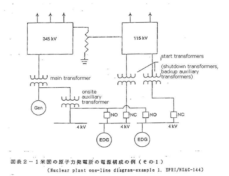

The report of 11 June 1993 by the SBO working group of the Nuclear Safety Commission is not a very long one (28 pages without attachments). To begin with, here are the contents :
http://www.nsc.go.jp/info/20110713_dis.pdf 2/96
- Contents -
1. Foreword
2. Positioning of full AC electric supply loss events (SBOs) in foreign countries and present status, etc.
2.1. Positioning and management of SBOs in foreign countries' regulations, and present status of plant design in foreign countries
2.2. AC electric supply loss precedents in foreign countries, etc.
2.3. Assessment of reliability against SBOs etc. in foreign countries
3. Positioning and management of SBOs in our country and present status, etc.
3.1. Positioning and management of SBOs
3.2. Present status of plant design regarding SBOs
3.3. Status of plant operation management performance
3.4. AC electric supply loss precedents etc.
3.5. Assessment of reliability against SBOs etc.
4. Assessment of guidelines and safety securing countermeasures against SBOs
5. Conclusion
5.1. Summary of investigation results
5.2. Questions to be treated in the future concerning SBOs
6. Attachments
Here is a translation of part 5 (Conclusions)
http://www.nsc.go.jp/info/20110713_dis.pdf 29/96
5. Conclusion
The following is the result of investigations on full AC electric supply loss events based on past operational achievements in our country's nuclear power plants or on reports from foreign countries that we referred to.
① There has not been any SBO precedent in Japan's nuclear power plants until now. However, as they constitute the main SBO precedents occurring in foreign countries, we investigated the 3 cases that occurred at light water reactors in the USA. Although it is difficult to study by direct comparison because the situation of design and operational management is not necessarily the same as in Japan, the points from those precedents that are to be reflected in Japanese nuclear power plants, as general lessons whose awareness must be renewed, are ① the importance of countermeasures against human errors (training of operators, etc.) and ② adequate inspections during nuclear reactor shutdowns, of the facilities whose purpose is to secure the safety of nuclear reactor facilities including electric supply equipments, and the importance of conservative design.
② In our country, the frequency of external power loss is low at about 0.01 /Reactor*Year, and in all precedents that occurred at nuclear power plants, the time taken to restore external electric power was 30 minutes or less. This is a high reliability compared with the United States' external power loss frequency of about 0.1 / Reactor*Year and external power restoration time's mean value of about 30 minutes, the longest being about 19 hours (statistics compiled until 1989).
③ Over the past 10 years, the emergency diesel generators (EDG)'s starting failure rate has been about 6x10^-4/demand in Japan. Compared with the United States' 2x10^-2/demand, our country's EDG reliability is high.
④ DC supply (emergency batteries, etc.) is especially important should a SBO happen. The capacity of emergency batteries in nuclear power plants in our country is 5 hours or more (on the basis where some of the loads are switched off). Also, as there is no precedent of failure of emergency DC supply system batteries, etc., it can be thought that reliability is maintained at a high level. In the United States, however, failures of DC supply emergency system batteries, etc. have been reported. Also, for example at Surry the capacity of emergency batteries, in the case where some of the loads are switched off, is estimated to be about 4 hours.
⑤ So, it can be thought that in our country, the reliability of external power systems, EDGs and emergency DC power system's emergency batteries etc., is good and SBOs are hard to be generated. Also, some nuclear power plants are designed to supply the emergency electric power system from a [third] power transmission system independent from the two circuits required by the guidelines, and some are designed to supply electric power from a neighbouring nuclear power plant.
⑥ If we try to evaluate plant resistance during SBO on the basis of the United States' RG1.155, the resisting time that is required is 4 hours. Against that requirement, the resisting time against SBOs of representative nuclear power plants in Japan is 5 hours or more with the response procedures already incorporated in manuals such as switching off some of the battery loads, so that the United States' NRC's SBO regulation is satisfied.
⑦ According to the Probabilistic Safety Analysis (PSA) results obtained in our country's representative nuclear power plants with internal causal factors alone, SBO-caused core damage frequencies are low, and they are also low in comparison with the United States' NRC's NUREG 1032 medium value of 10^-5/Reactor*Year. The total core damage frequencies, including this, are also low.
⑧ Concerning regulatory requirements against SBOs in the major foreign countries, the United States and France have regulatory requirements against SBOs (including prolonged SBOs). The United Kingdom and Germany have regulatory requirements that are nearly similar with the Japanese ones.
The present good operational management, maintenance and margin-allowing design being continued, in order to enhance safety to a higher level, the following additional steps are desirable:
① In order to enhance the Japanese nuclear power plants' safety against SBOs to a higher level, it is obvious that a situation where the operators are sufficiently trained with the manual must be maintained, but in the case new knowledge is obtained it is necessary to make efforts to appropriately reflect that new knowledge in design, operation, maintenance and manual, etc..
② The core damage frequency obtained in the probabilistic safety analysis results of nuclear power plants representative of our country are not especially high, but while conducting studies, etc. of the SBO core damage frequency by probabilistic safety analysis at individual plants, it is important to make efforts to conduct the studies that will pave the way toward a higher efficiency level of preparatory measures such as accident management.
③ While maintaining the present situation of good operation and maintenance in our country's nuclear power plants, in view of the fact that in probabilistic safety analysis the collection of the data of our country's nuclear power plants is important, it is desired that in the future the data concerning the reliability of EDGs when they are started, and the reliability of their continuous operation after starting are collected and arranged, and that they are studied and reflected in analysis of failure rates and in probabilistic safety analysis.

Some more translation of the same report:
http://www.nsc.go.jp/info/20110713_dis.pdf 3/96
1. Foreword
Full AC electric supply loss events (Station Blackout, noted below as "SBO") are the "simultaneous occurrence of external AC electric supply loss and the loss of the plant's internal emergency AC electric supply" (Note).
In other words, SBOs are compound events generated when the external power supply is fully lost, and for example all the emergency diesel generators (noted below as "EDG") fail from starting. It can be thought that their frequency is extremely low.
To be prepared should a SBO occur, nuclear power plants are designed so that, against the occurrence of short time SBOs, the reactor is safely shut down and cooling can be secured after shut down. However, in the hypothetical case where AC power cannot be restored within a short time and the SBO is prolonged, because emergency batteries run out, the operation monitoring and control functions, etc. are lost and core cooling can no longer be maintained, so that it is thought that the possibility emerges that it leads to major results such as core damage. However, in recent years, probabilistic safety analysis (noted below as "PSA") which quantitatively analyses and estimates the probability for example of core damage in all accident scenarios that can be presumed, including events whose frequency is thought to be extremely low such as SBOs, has been performed in many countries.
① Reflecting for example the fact that, short time ones though they are (within the limits of the present study the longest one is 36 minutes), SBO precedents have been reported in foreign countries;
② Reflecting for example that it has been reported, according to PSA results in representative American nuclear power plants, that there are nuclear power plants where SBO is an important contributory factor to core damage; and
③ Reflecting for example the fact that in recent years, in the United States, regulatory measures have been taken against SBOs,
as developed below, the present working group investigated and compiled findings mainly on the present status of SBO regulatory requirements, accident and malfunction precedents at nuclear power plants in Japan and abroad.
Note: In our country's "safety design examination guideline for electricity-generating light water nuclear reactor facilities" [ online version: http://www.nsc.go.jp/shinsashishin/pdf/1/si002.pdf ], it is called "full AC electric power supply loss event".

Let's have a look at this "safety design examination guideline(s) for electricity-generating light water nuclear reactor facilities" [ online version: http://www.nsc.go.jp/shinsashishin/pdf/1/si002.pdf ].
It is made of two parts. From page 1 to 13 you can find the regulation's main text:
I. Foreword
II. Positioning and application domain of the present guideline(s)
III. Definitions (1)...(20)
IV. Nuclear power plant in general (Guideline 1... Guideline 10)
V. Nuclear reactor and nuclear reactor shutdown system (Guideline 11... Guideline 18)
VI. Reactor cooling systems (Guideline 19... Guideline 27)
VII. PCV (Guideline 28... Guideline 33)
VIII. Safety securing systems (Guideline 34... Guideline 40)
IX. Central control room and emergency facilities (Guideline 41... Guideline 46)
X. Measurement/controls and electric systems (Guideline 47... Guideline 48)
XI. Fuel handling systems (Guideline 49... Guideline 51)
XII. Radioactive waste treatment facilities (Guideline 52... Guideline 55)
XIII. Radioactive exposure management (Guideline 56... Guideline 59)
Then, from page 14 to 27, are the "explanations" that apply to a selection of definitions and guideline numbers.
SBOs are mentioned in Guideline 27, page 7:
Guideline 27. Design considerations against electric supply loss
Against short time full AC electric power supply loss at nuclear reactor facilities, the design shall ensure that reactor is safely shut down, and that cooling can be secured after shutdown.
They are mentioned again in the explanation for guideline 27, page 22:
As the restoration of electric transmission lines or the repair of the emergency AC electric supply equipments can be expected, it is not necessary to consider prolonged full AC electric power supply loss.
In the case where the degree of reliability of emergency AC electric supply equipments is sufficiently high due to the system's construction or use (for example by having it normally running), it is not necessary for design to assume full AC electric power supply loss.
  • #393

Some more translation. http://www.nsc.go.jp/info/20110713_dis.pdf page 2-4 (4/96-6/96).
2.1.1. United States
(1) Positioning and management of American SBO regulations
The Reactor Safety Study published in 1975 showed that SBO is an important contributor to core damage frequency, and made clear that the reliability of American emergency AC generators was not as high as had been presumed until then.
For that reason, in 1979, the Nuclear Regulatory Commission (NRC) designed SBO as Unresolved Safety Issue (USI) A-44, and started in July 1980 to study whether new regulatory requirements must be carried out.
In June 1988, the NRC published NUREG-1032, containing a technical evaluation of SBOs with evaluations of loss of offsite power frequency and duration, emergency AC generating systems' reliability, etc.. In it, it was said that it was desirable to keep SBO generated core damage frequencies below 10^-5/Reactor*Year and concluded that each nuclear power plant should possesses enough resistance so that a 2~8 hour long SBO would not lead to core damage. In reaction, adding 10CFR50.63 : "Loss of all alternating current power" (mentioned below as "SBO") to the Code of Federal Regulation, the NRC made a legal requirement to assess if enough resistance is provided against SBO, or if countermeasures such as installing backup AC power supplies are necessary. Also, the Regulatory Guide 1.155 (mentioned below as "RG1.155"), which details how the NRC staff concretely assesses resistance against SBO, was published in August 1988.
On the other hand, the Nuclear Utility Management and Resources Council (NUMARC) which is a federation of power companies and reactor makers, compiled NUMARC-8700 containing an assessment procedure even more detailed than RG1-155. The NRC staff reviewed NUMARC-8700 and approved the method contained in it.
Using the NUMARC-8700 procedure, each nuclear power plant owning American power company submitted an SBO assessment to the NRC by 17 April 1989. These were reviewed by the NRC which approved the companies' plans to change equipments or manuals at about one half of the plants, instructing them to do so within two years. Eventually, the equipment and manual changes should be completed by the end of 1994.
(2) Outline of present status of American plant design and operational management
The construction of American nuclear power plants' power supply systems varies from plant to plant, but basically they are as shown on figures 2-1 and 2-2 [http://www.nsc.go.jp/info/20110713_dis.pdf 32/96-33/96].
Many American plants are connected to the grid via two different voltage transmission lines. In normal time, onsite loads are supplied via auxiliary transformers connected to the main generator. When the reactor is started and shut down, they are supplied via the start transformers (also called shutdown transformers or backup auxiliary transformers). The safety related systems and equipments are supplied according to the operators' choice between the onsite auxiliary transformer, the start transformer or the EDGs. In the case where for example the main generator trips and power cannot be supplied by the onsite auxiliary generator, the safety related systems and equipments are automatically switched to the start transformer or EDG. The priority between start transformer and EDG varies between plants. In the case where there are several start transformers, that too becomes backup. In the case where all offsite power is lost, EDGs start automatically, and safety realted systems and equipments are supplied.
In the case the resistance against SBO specified in RG1.155 is not met, the compulsory installation of backup AC power supply specified in SBO regulations consists of an onsite AC generator or one which can be supplied from a location close to the plant. Concretely, it is as shown in the following examples: on single reactor sites, they install an EDG not belonging to the emergency partition, or power equipments receiving power from an offsite thermal or hydraulic power plant. On multiple reactor sites, there is a cross tie between emergency busses. Examples are shown on figures 2-3 and 2-4 [http://www.nsc.go.jp/info/20110713_dis.pdf 34/96-35/96].
The operation management of American nuclear power plants is regulated by the technical specifications. We present below the outline of operation management of electric systems as regulated in standard technical specifications for an undetermined plant.
1) EDG surveillance
① starting test without load
It consists of verifying that the specified revolution speed, generated voltage, frequency are secured 10 seconds after a manual start signal or a mock-up loss of offsite power signal.
② continuous test with load
Performed without break after the starting test, it consists in verifying that synchronization and specified voltage are secured within 60 seconds and that it can keep running that way for at least 60 minutes.
③ EDG test frequency
The frequency of starting tests without load and continuous tests with load depend on past test results. If the past 100 tests generated 0 or 1 malfunction, tests are performed at least once every 31 days. In the case of 2 malfunctions, at least once every two weeks, In the case of 3 malfunctions, at least once every week. In the case of 4 or more malfunctions, at least once every 3 days.
④ EDG tests during reactor shutdown
In addition to the above mentioned starting tests without load and continuous tests with load, some tests must be performed at least once every 18 months during reactor shutdown. The main ones are a 24 hour test with load, a breaking test with load verifying the circuit breaking capacity, an automatic introduction test verifying load break and connection by a load sequencer during loss of offsite power, etc. Moreover, a simultaneous start test verifying the separation and independance of 2 EDGs is performed at least once every 10 years. 2) Inspection of DC power supplies such as batteries
The following inspections are performed on 250/125 V batteries and battery chargers:
① Inspection performed at least once every week
check of electrolyte surface in representative cells, voltage check, specific gravity measurement.
② Inspection performed at least once every 92 days
check of electrolyte surface in every cells, voltage check, specific gravity measurement, mean temperature of 6 cell electrolytes, voltage inspection of the battery as a whole, electric current inspection during floating charge.
③ Inspection performed at least once every 18 months
visual inspection of every battery cell, terminal board, rack, etc., visual inspection and measurement of resistance of connection lines between cells, 8 hour long charging test.
④ Inspection performed at least once every 18 months during reactor shutdown
8 hour long connection to real load to test electric power supply capacity.
⑤ Inspection performed at least once every 60 months during reactor shutdown
Discharge test.
2.1.2. Germany
  • #399
