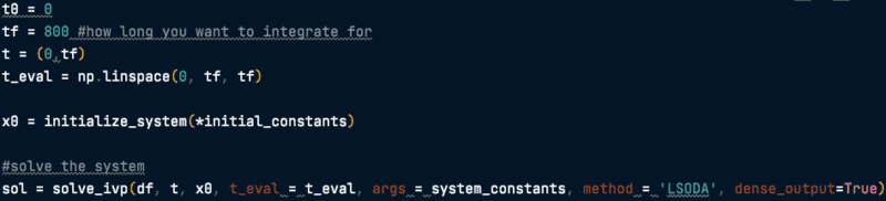

I regenerated the solid CO2 buildup array after the integrator (rather than extracting the solution from the integrator), and plotted the integrator solution (blue) versus the manually recreated solution (orange):
The manually created orange one has a better shape in that the buildup declines to zero at a rate closer to that seen in Tuinier et al.
I made the orange array with the assumption that the total solid CO2 on the bed at any time will be equal to the total solid CO2 on the bed at the previous time plus the net desublimation rate across the bed (i.e. summing the desublimation rate for each position), times the surface area available for desublimation in each bed. So something like this:
$$M_{CO2, t} = M_{CO2,t-1} + \sum_{j=1}^nMDR_t*SA$$
where MDR is the molar desublimation rate in a tank and SA is the surface area available for desublimation in the tank

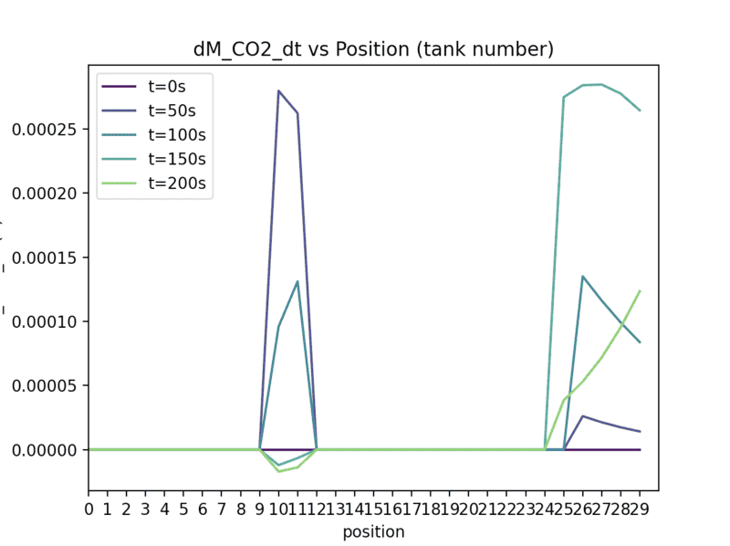

Just looking into this integrator integration a bit more - I'm printing out the value of both dMCO2/dt and MCO2 at each time, to check that ##M_{CO2,t} = M_{CO2,t-1} + dMCO2dt## when MCO2>0 and it doesn't seem to be:

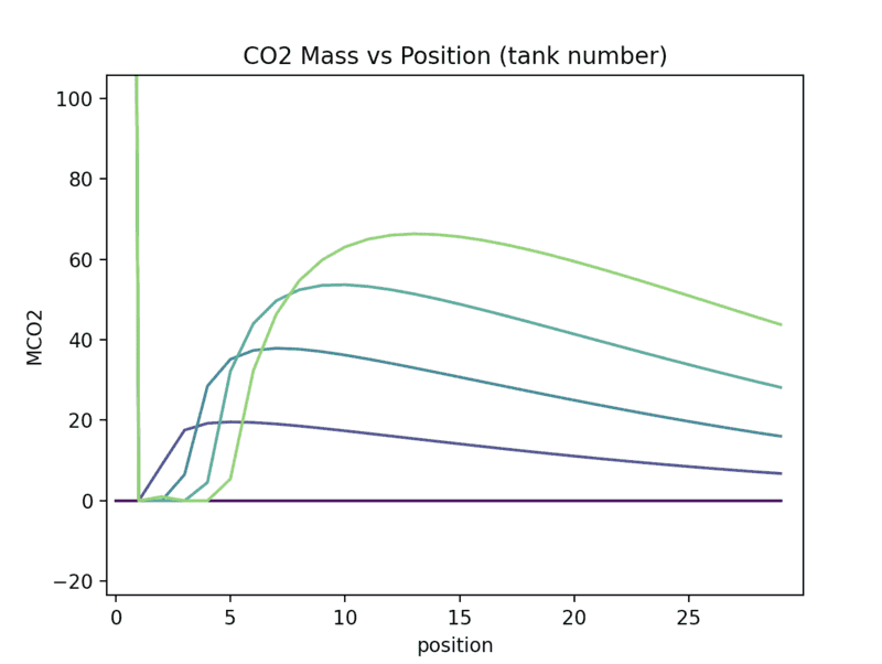

There are two issues here. Firstly the rate of deposition is negative at the start, and secondly the above equation doesn't seem to apply anywhere.
Seeing that the sign is negative at the beginning, its possible that these are actually sublimation rates (which would be negative at the beginning), meaning that my logic to deal with MCO2<0 might be incorrect

Plotting the total solid buildup (somewhat corrected) for both the integrator (blue) and manually (orange), actually shows the integrator perfectly matches the manual recreation up until t=200, and then the manual one starts to decrease while the integrator increases further.
Anyway just working through this. Just said I'd post in case a plot like this is indicative of some error type in particular. It may be a sign error at this point (t=200) since they somewhat mirror one another from t=200 through y=0.13 (approx).

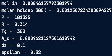

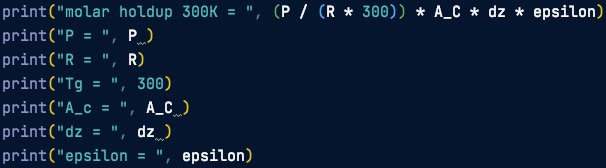

Don't forget to take into account the number of moles of N2 that was in the column to begin with.
  • #333
Ah so to account for initial N2 I've calculated the molar holdup of gas in the column initially (##m_j##), is there somewhere else I should account for the initial N2?

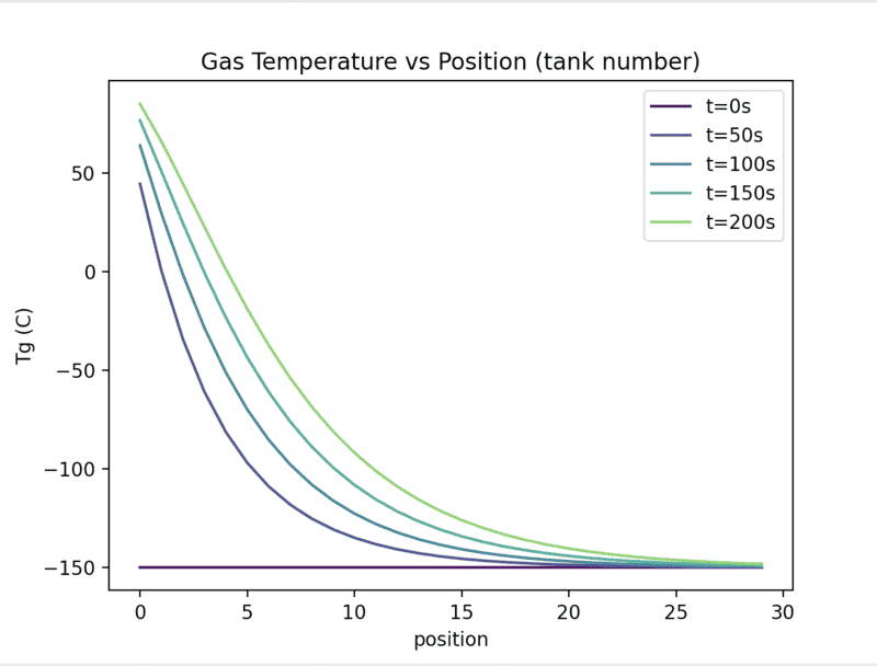

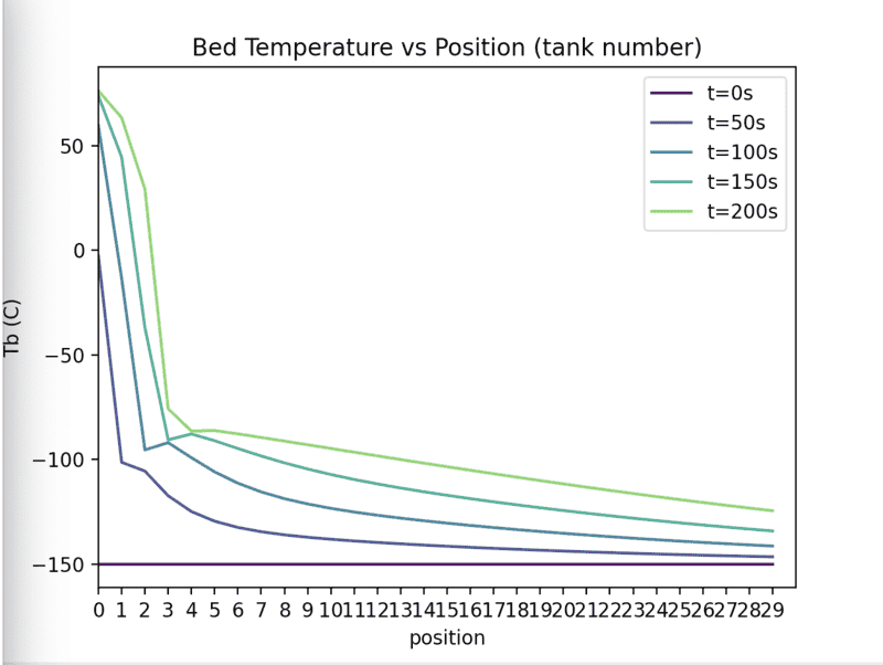

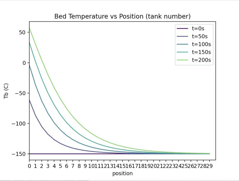

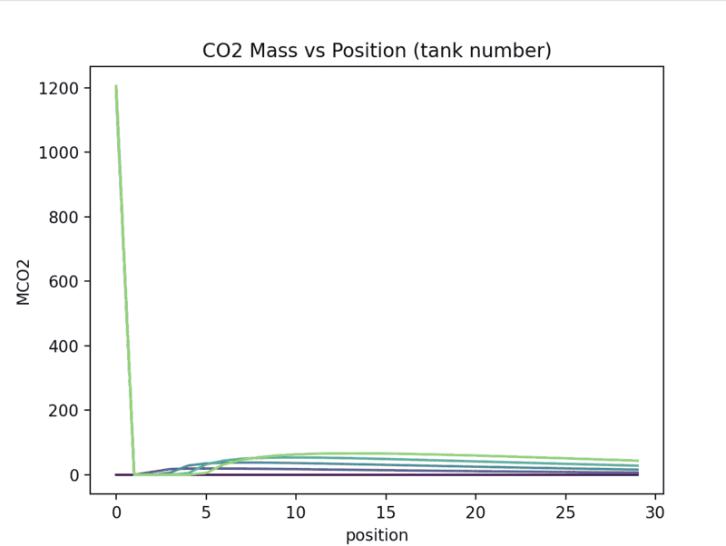

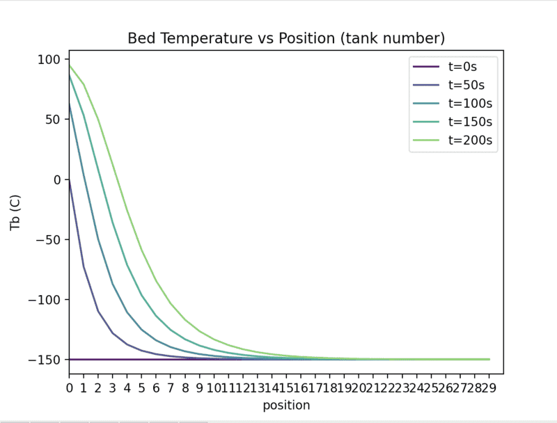

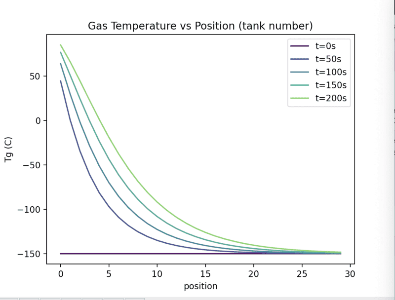

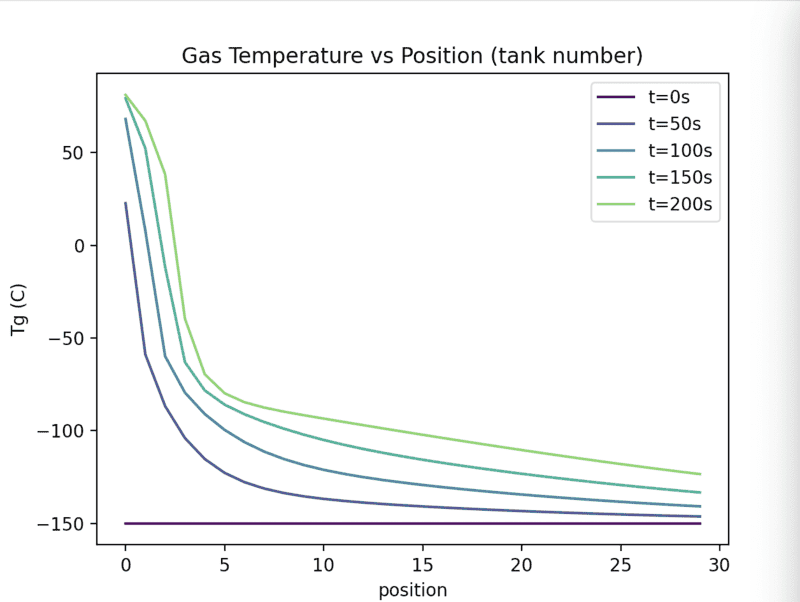

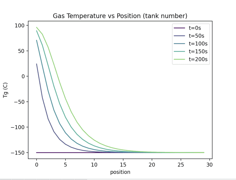

I think I've narrowed it down to an error with the MDR/MLR functions (molar desublimation/liquefaction rates) i.e. this equation: $$M_i'' = \frac{k_i(Py_i - P(T_I))}{RT}$$
Reason being is the follows - when I set the mass transfer rate equal to zero (##k_i## = 0 for CO2 and h2o), everything works:
- the mole balance works (see below moles in > moles out):
The CO2 mole fraction equation works (see below it levels out at 0.2, whereas with mass transfer turned on it levels out at 0.35 which is impossible since the inlet mole fraction is 0.2):
Lastly the temperature profiles work (see below the temperature levelling out at the inlet gas temperature, rather than some temperature below this):

However when the mass transfer is turned up (k_i = 8*10^-4) these trends no longer work:
Temperature levels out at a low value:
The sublimation is much slower than the desublimation:
And lastly the CO2 mole fraction levels out at an impossible value:
It seems odd to me that there is a 'cut off' k_i value where the trends are no longer right, because k_i doesn't change the sign of MDR/MLR (molar desublimation/liquefaction rates), just the magnitude.
There is a fault in my MDR/MLR logic which potentially causes large molar flow rates at the inlet. Close to t=0, the y_CO2 value is so low that the MDR is actually negative. Could I add in some correction to say that if the y_CO2 value is extremely low then assume MDR = 0, or similar?

  • #341
I calculate a final total CO2 gas holdup of 0.0006 moles, which is roughly half the value on this graph.
  • #342
Exactly yes the reason its half the value is because the temperature profile (with mass transfer turned on) is the following (below), where the temperature levels out at a value approximately half of the correct value (shown further below):
However to get the correct profile above I have to turn off mass transfer, meaning that the issue is definitely related to the mass transfer.
Looking at the desublimation rate at short time, I see that it is actually negative initially (indicating sublimation). This 1) doesn't seem to make sense as the bed is cold and 2) causes ##\dot{m}_{out}## > ##\dot{m}_{in}## which isn't possible.
So why is there apparently sublimation occurring at short times? Well if (in the equation below) ##Py_i## is less than ##P(T_I)## then this will occur. The issue is that at short times ##y_i## is so small that this equation says there is sublimation happening not desublimation. Is this correct or should I add a further constraint to stop this?
The equation for reference:

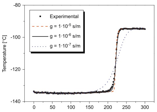

Let's. try the trick factor that Tuinier et al use, appropriately corrected for our units: ##\frac{m_i}{m_i+0.1}##
  • #344
So we let desublimation as it is, and add in this trick factor for sublimation?
To convert their units (kg/m3) to ours (they use mol/m3) I guess we would just need to multiply each ##m_i## term by ##\frac{1000}{mW}##?
That is interesting though. I had thought that desublimation was dependent on temperature and pressure only. I did not realize that a sufficiently low ##y_i## (and therefore a sufficiently low partial pressure) would mean that sublimation actually occurs
Also a note - I'm using units of pascals for the ##M_i''## equation calculation

Adding in the fudge factor seems to fix the temperature profile issue, and the other plots look a bit better also. Also the final molar holdup is now 0.006 also:
Edit: I'm not sure what the benefit of the fudge factor is though. What is this for? To ensure that sublimation is slightly more inhibited than desublimation?

I think our units are moles in each tank. We would multiply both numerator and denominator of their factor (including the 0.1 term) by ##\frac{(1000)A_C\Delta z}{molecular\ weight}## to get ours.
It doesn't mean this. All this does is make sure that the mass deposited never gets less than -0.1 kg/m^3 (which is not significant). If the deposited mass tries to go negative, we add mass. Their purpose of this factor was just to provide smoothing of the behavior (not to model actual behavior) so that the deposited mass can't stay negative by more than 0.1.
The P/RT is supposed to be moles/m^3 of gas.
  • #347

No. To avoid in a smooth manner the deposition going negative by more the 0.1 kg/m^3 (insignificant amount). it's a numerical trick.

Anyway yes in regards to the factor above - we're solving for ##M_{CO2}## (mass of deposited CO2) at each space/time increment so can I simply add this factor to the sublimation equation?: $$trick factor = \frac{M_{CO2}}{M_{CO2} + 0.1}$$
If so, then here's the output with that factor included:
The molar holdup levels out at a value of 0.006 which is what you previously calculated
And the positional plots have similar peaks to the Tuinier data (the sublimation is still slower than it is in Tuinier et al though):
  • #349
casualguitar said:
I guess we would just be multiplying the ##m_i## terms by the above factor to convert from kg/m3 to mol/tank, or else the factor would cancel out?When I said this what I meant was that this equation ##M_i'' = \frac{k_i(Py_i - P(T_I))}{RT}## seems to say that sublimation is a function of mole fraction (in addition to P and T), meaning that even with a temperature and pressure below the sublimation temperature, sublimation may still occur if the mole fraction of the species, ##y_i## is sufficiently low. I think anyway.
No. This only happens to a tiny extent when we use the fudge factor. The idea is to not let the deposition amount become significantly less than 0 as a result of slight numerical overshoot.
I think you mean moles of deposited CO2 here. In any event, the fudge factor should, as I indicated earlier, be $$trick factor = \frac{M_{CO2}}{M_{CO2} + 0.1\frac{(1000)A_C\Delta z}{(molecular\ weight \ of \ CO2)}}$$A corresponding equation applies to water.
This is what it would take to make your calculations equivalent to theirs, at least with regard to the fudge factor.
View attachment 312827View attachment 312828
You need to work toward (1) using the correct equivalent fudge factors, (2) increasing to 30 tanks, and (3) using our mass transfer parameterization.

So with the correct equivalent fudge factor, and n=30, the output is below
Are we not already using our mass transfer parameterisation? Or is there something I have left out?
Here is the output:
The CO2 solid moles buildup looks pretty close to the Tuinier plot. I have one or two ideas as for why the sublimation is slower. I'll look into this.
But yes, what did you mean by 'our mass transfer parameterization' if not this equation: ##M_i'' = \frac{k_i(Py_i - P(T_I))}{RT}##
