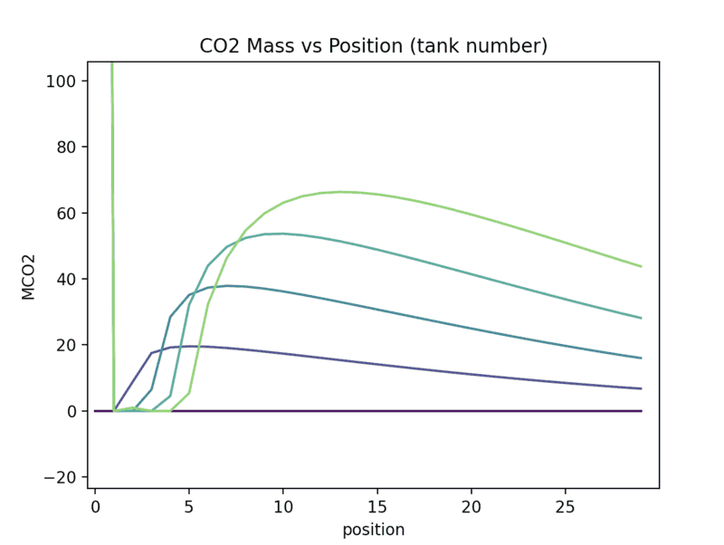

  • #252
Chestermiller said:
On second thought, surface area to volume ratio of a particle is $$\frac{4\pi r_p^2}{\frac{4}{3}\pi r_p^3}=\frac{3}{r_p}=\frac{6}{d_p}$$The particle volume per bed column volume is ##1-\epsilon##. The column volume per tank is ##A_c\Delta z##. So, the available deposition area per tank is $$\frac{6}{d_p}(1-\epsilon)A_c\Delta z$$
The units here seem to be ##mol.m^2## whereas the units in Tuinier et al are ##kg.m^3##. Is ##m^2## right here?
Also, if the above is correct then I've potentially made a mistake elsewhere -

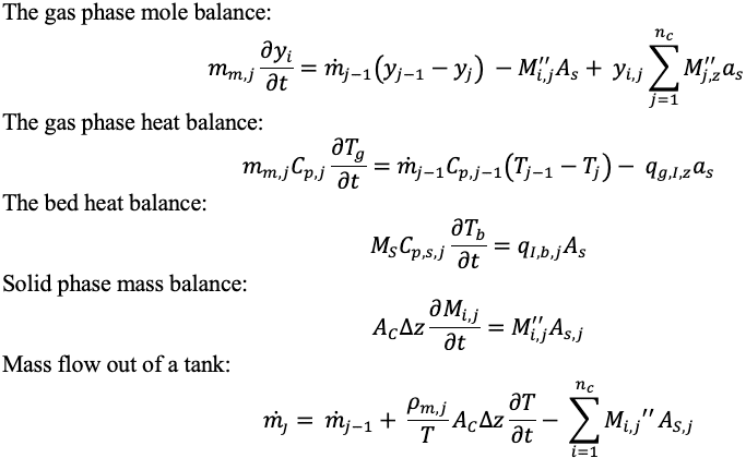

The solid phase mass balance is:
And I have defined ##a_s## (the specific surface area), as ##\frac{6}{d_p}(1-\epsilon)A_c\Delta z##. Is this incorrect? Everywhere we have ##a_s## in the model equations I have used the above

  • #253
Remember, we decided to work in terms of moles rather than mass. This is signified by using M rather than m. Also, the subscript "I" signifies that it is averaged over tank i.
In our development, ##a_s## is the surface area available for deposition in tank i.
In our development, this is correct to use. Of course, you have to be able to convert from our notation to theirs to compare the results. Are you not able to do this?

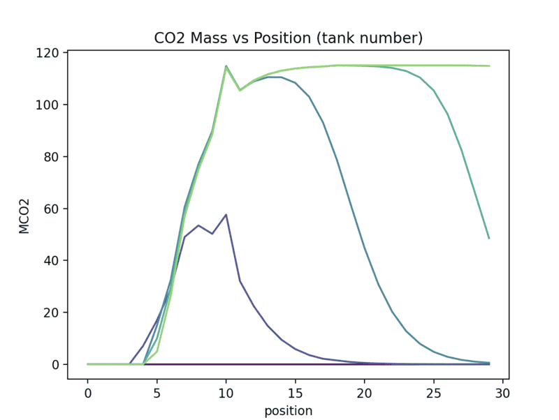

  • #254

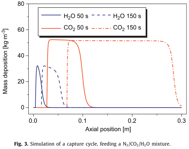

Yes apologies for the confusion I'm ok with the kg and mol difference however their plot here seems to have m3 in the units whereas ours has ##m^2## instead
So I'm not fully clear on how to convert between yet. ##m^2## makes sense to me as we're looking for the amount of solid available for deposition. Why would they use ##m^3## here?

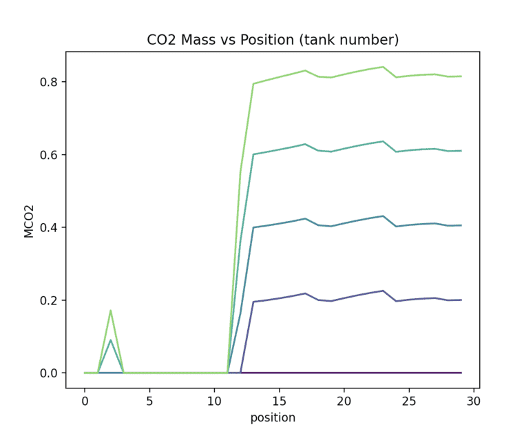

  • #255

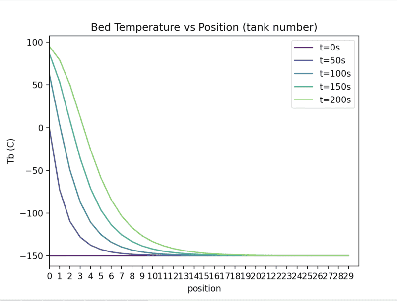

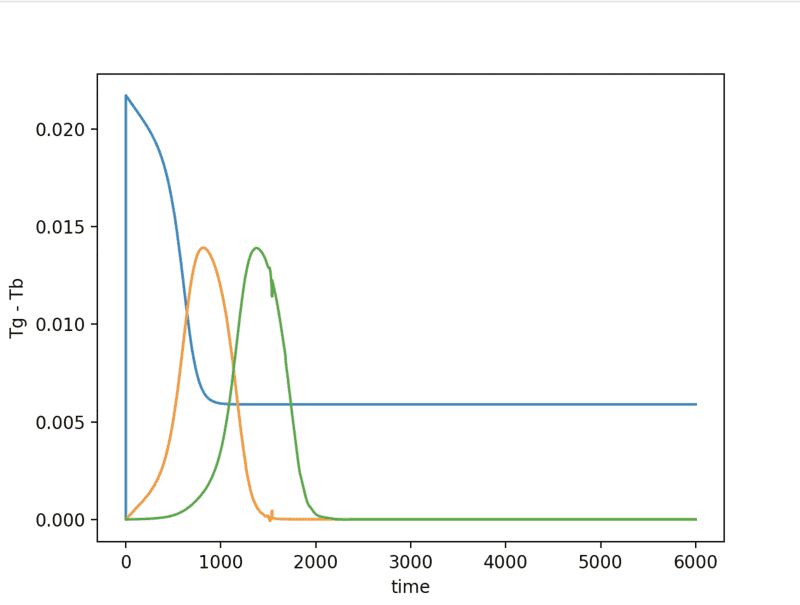

In addition, the difference in ##Q_{GI}## values stems from the ##\Delta T## between gas and bed at the inlet being higher than the delta T for the internal nodes:
I'm not sure why this happens yet. I would have expected the blue curve to be similar to the orange and green curves. Looking into it

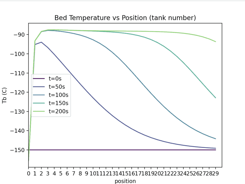

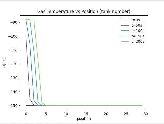

  • #256

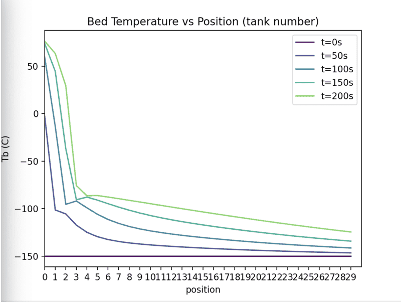

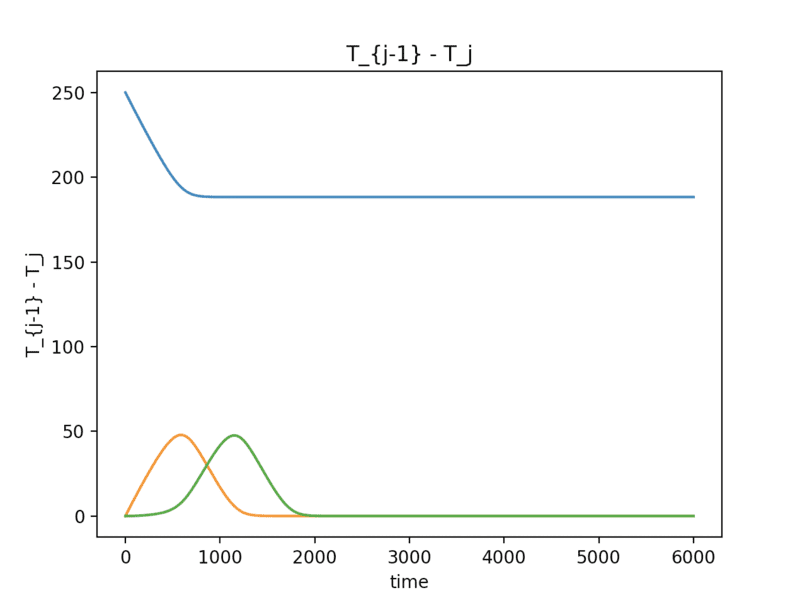

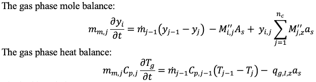

Final update (apologies). So the reason that there is more variation at the inlet is this -
The gas phase heat balance is this:
When setting up this equation, I have one equation for the boundary tank (which I think is tank zero), and one equation for the other tanks.
##\dot{m}_{j-1}## is the inlet molar flow rate for tank zero (boundary tank) and ##T_{j-1}## is the inlet flow temperature.
For the rest of the system I just take the outlet flow and temperature from the previous tank and use this for the ##j-1## values.
So plotting ##T_{j-1} - T_j## for all tanks gives:
which shows that there is a much larger temperature change occurring at the boundary always. Is this expected?
  • #257
Yes. My bad. Their ##m_i## is supposed to be mass per unit of bed volume (actually column volume). So their ##a_s## is equal to ##\frac{6}{d_p}(1-\epsilon)##, and is the deposition surface area per unit volume of column. Our ##M_i## is supposed to be total moles of species deposited on solid surface in tank and our ##M_i^"## is the moles of species deposited per unit time per unit of deposition surface in tank. So, $$M_i=\frac{1000m_iA_c\Delta z}{W_i}$$and$$M_i^"=\frac{1000m_i^"A_c\Delta z}{W_i}$$where ##W_i## is the molecular weight of the species.

What is your exact equation for tank 1?
  • #259
By tank 1 (if we're talking about the boundary tank), then my exact equation gas phase heat balance is:
$$\frac{\partial T_g}{\partial t} = \frac{\dot{m}_{in}C_{p}(T_{in} - T_1) - q_{g,I}A_s}{m_1C_{p}}$$
where ##\dot{m}_{in}## is the inlet molar flow and ##T_{in}## is the temperature of the inlet flow, and ##m_1## is the molar holdup in tank 1
Is this reasonable?
and here is the general equation:
$$\frac{\partial T_g}{\partial t} = \frac{\dot{m}_{j-1}C_{p}(T_{j-1} - T_j) - q_{g,I}A_s}{m_1C_{p}}$$
  • #260
Is this reasonable?
Looks OK
  • #261
Chestermiller said:
Looks OK

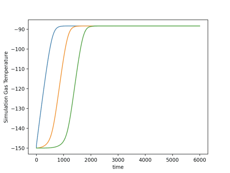

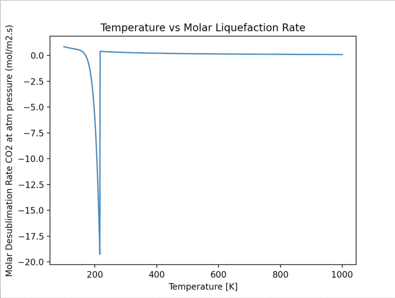

So the boundary condition equation is set up ok. This graph doesn't seem intuitive though (##T_{j-1}## - ##T_j## for all tanks). This delta T discrepancy is driving the higher rate of variation at the inlet:
Maybe one of the heat transfer terms driving heat transfer axially through the bed is low? The ##Q_GI## term at the inlet is much higher than ##Q_GI## for the other tanks also. I don't think this is to be expected.
I've checked the molar desublimation rates across the bed and they seem ok everywhere.
I messed around with the heat of vaporisations/desublimations just on the off chance they were incorrect. Currently the heat of desublimation and vaporisation are 26000 and 40650 J/mol respectively. If I just divide them both by 1000 (no particular reason other than maybe the current units are wrong), then the gas temperature levels off at a higher temperature. Still too low, but higher. Suggesting maybe that this is a value error rather than a desublimation mechanics error?
Plot of gas temperature with the heat of vaporisation/desublimation values divided by 1000:
Original values:
  • #262

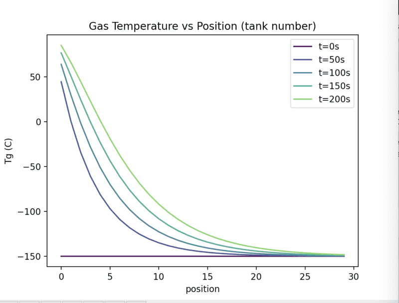

Slightly more interestingly, if I divide those heat of vaporisation/desublimation values by 1000 again then we get a relatively normal looking profile (note these temperatures are degrees C):
This might suggest that I haven't divided by 1000 somewhere where I should have. 1000 would come up when converting from kg to mol so maybe I haven't done that somewhere? Complete guess but will check

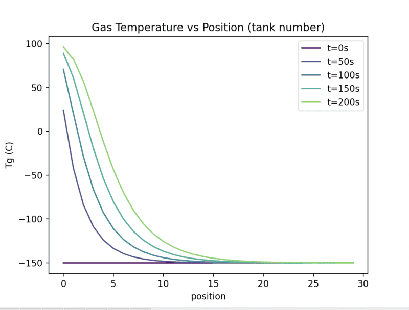

If it wouldn't be too much trouble, could you please plot up the 30 tank results of temperature vs distance and CO2 deposited vs distance (with time as a secondary parameter) using the units in the Turnier paper so that we can compare directly with their paper. Thanks.

So the last two plots in post #261 show the temperature levelling off at a temperature that is below the inlet temperature (100C). I was pointing out in post #262 that if the heat of vaporisation/sublimation is multiplied by a factor of about 1000 then we get the correct 'temperature level off'. Obviously we can't just multiply by 1000 though so I thought maybe a factor of 1000 was missing somewhere else (possibly I hadn't converted between kg and mol properly somewhere). Just a thought though. But more importantly it shows that the desublimation/vaporisation mechanics aren't fully broken in that the gas temperature can go beyond the desublimation/vaporisation temperature

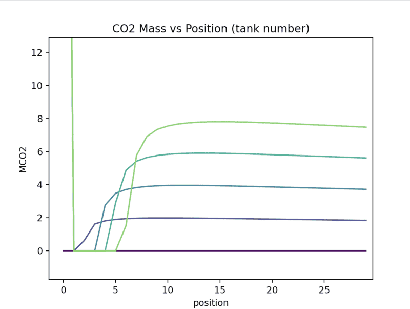

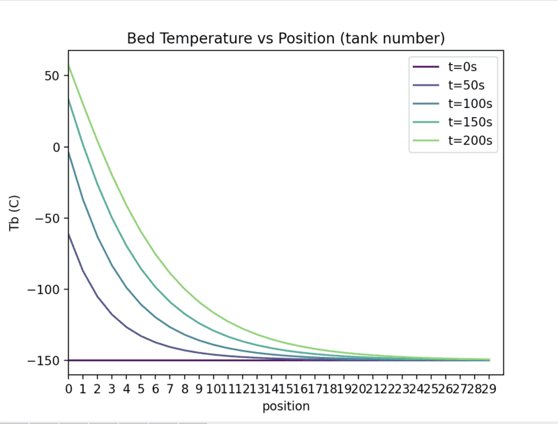

  • #268

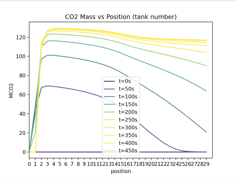

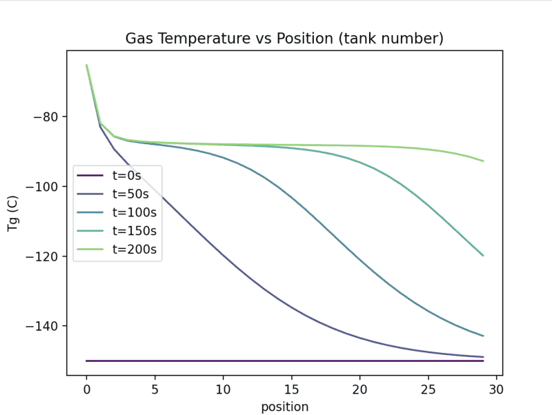

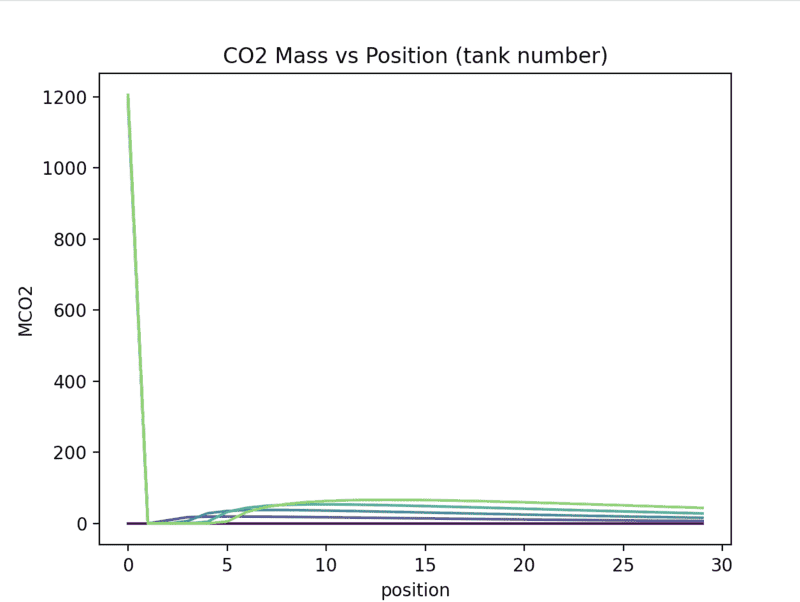

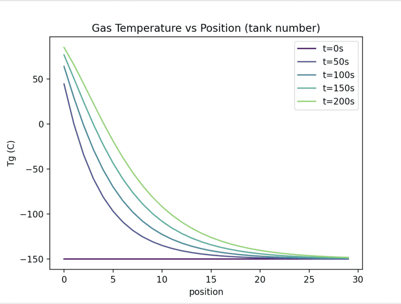

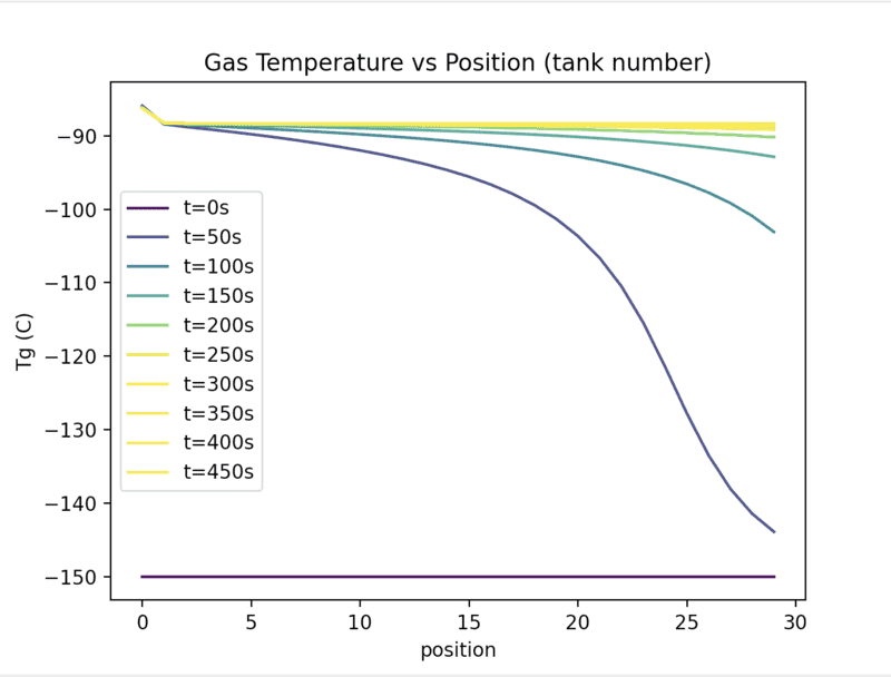

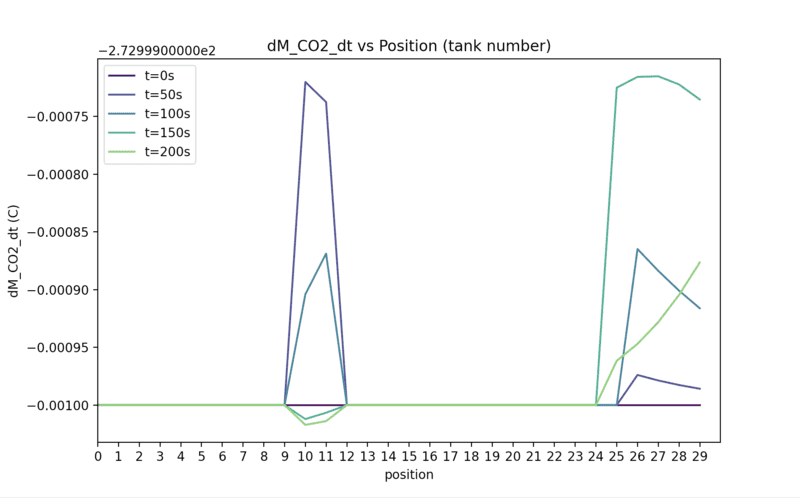

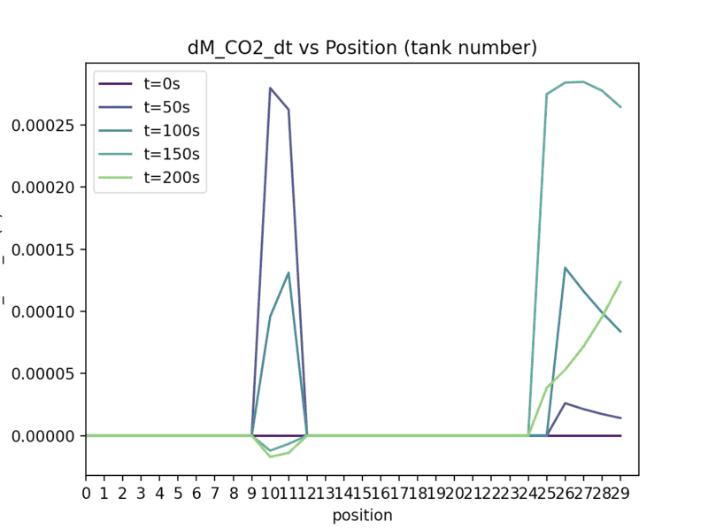

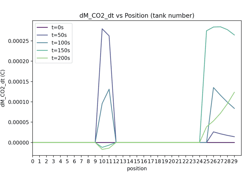

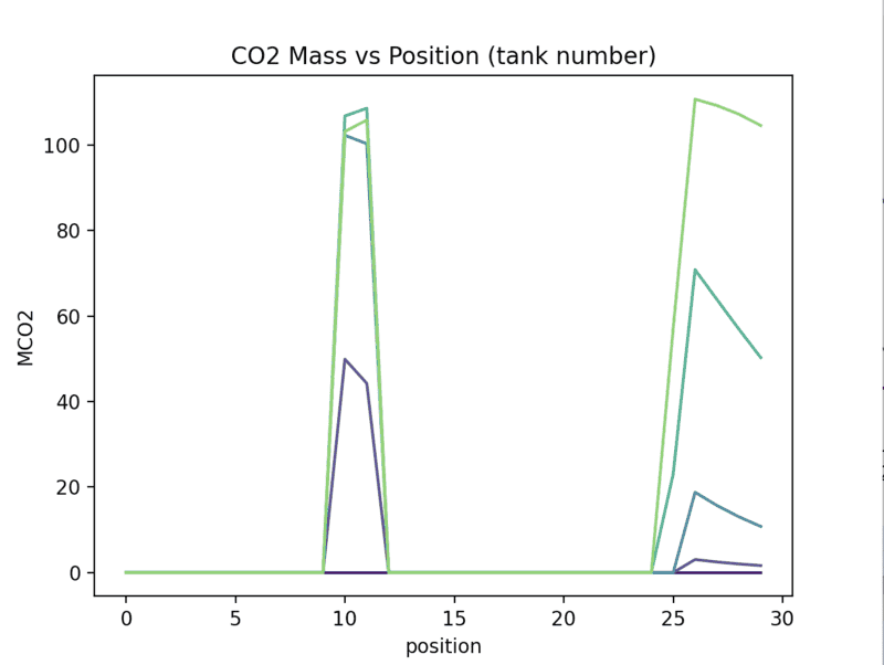

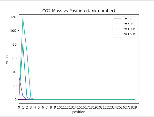

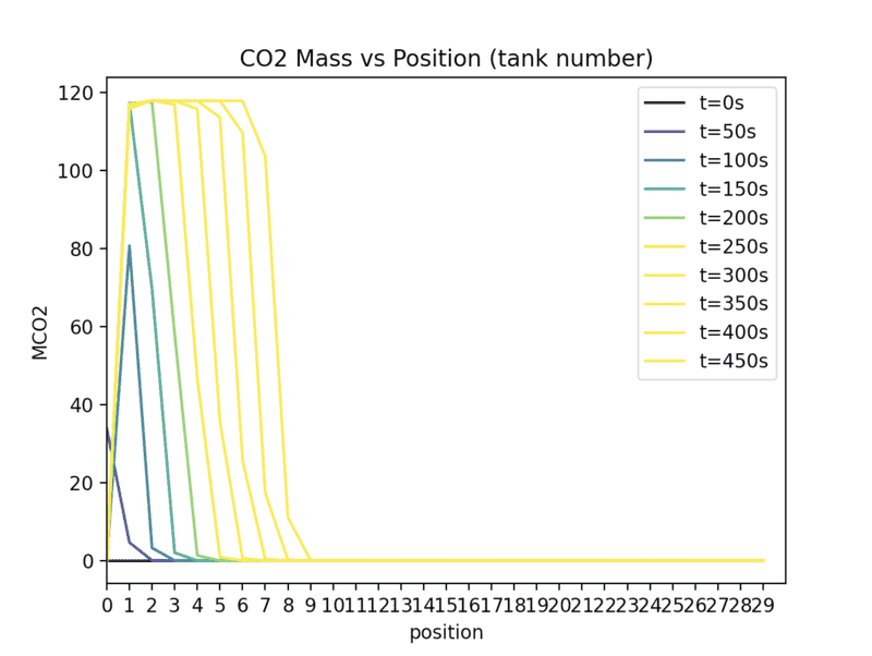

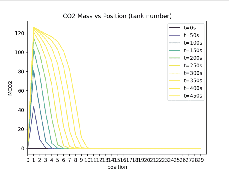

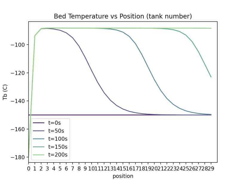

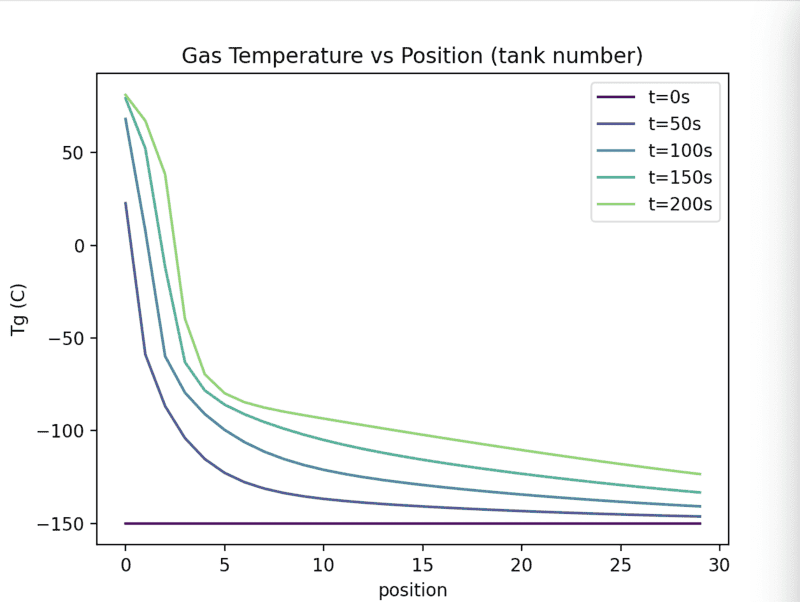

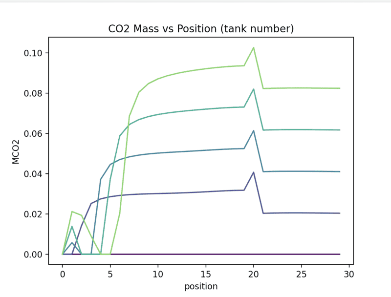

Here are the plots of position vs Mass of solid CO2 build up and position versus gas temperature (for a selection of times):
Some notes:
- The CO2 mass buildup is in the general ballpark of the Tuinier et al paper. The max buildup I see (about 120 kg/m3) is about double what the Tuinier et al paper shows
- Secondly, as you said earlier the activity in the above plots seems to be concentrated at the inlet much more so than the Tuinier et al plots (unless I'm reading it incorrectly)
- Lastly the gas temperature seems to max out at about -90C which is not the case in the Tuinier paper. We initially thought this was to do with sublimation mechanics but now that we can fix this by 'dividing the heat of vaporisation/sublimation by 1000', maybe this isn't the case
I'll take a look for forgotten 'divisions by 1000'. If there's any other useful plots I could do just let me know

Those changes had been incorporated anyway. The plots above (post #268) are the plots you mentioned earlier and use as much of the Tuinier data as possible. In places I had to make assumptions (like picking very high ##U_g## and ##U_b## values to approximate their infinite gas-solid heat transfer coefficient). Unless I've read the plots incorrectly they're not very similar yet. I'm looking into the possibility that I've forgotten to convert between kg and mol somewhere along the way

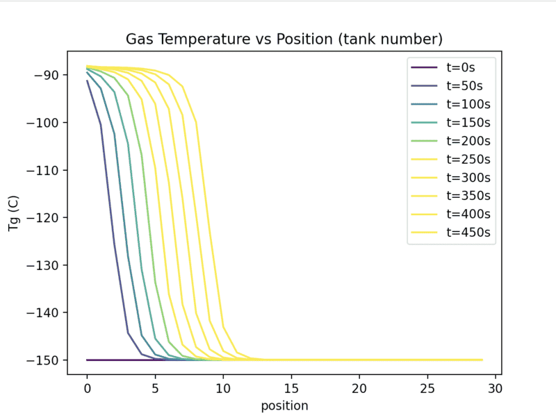

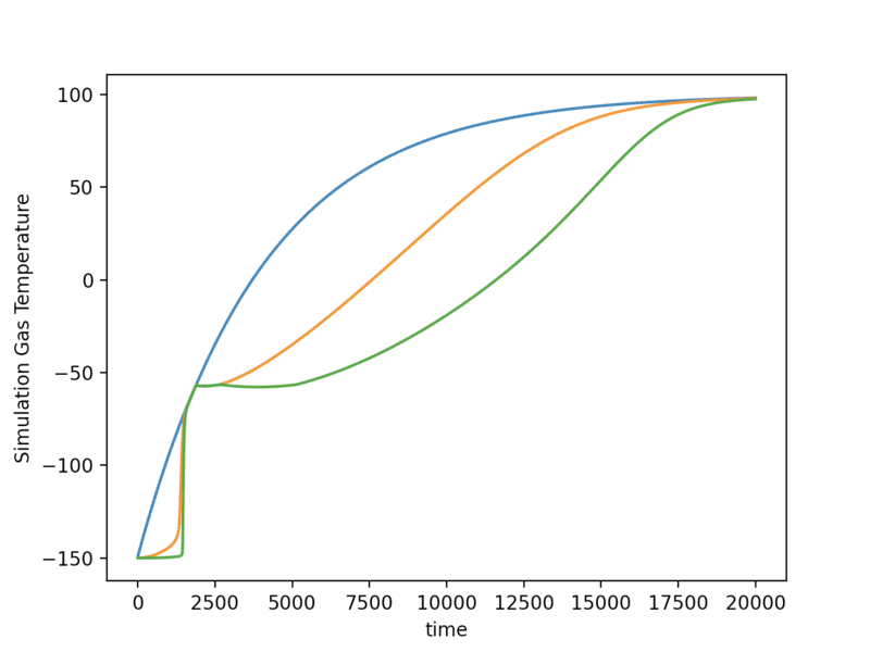

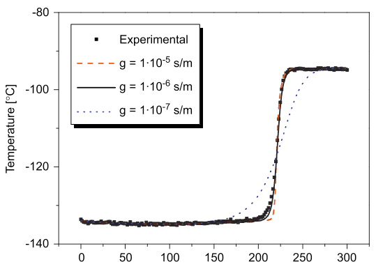

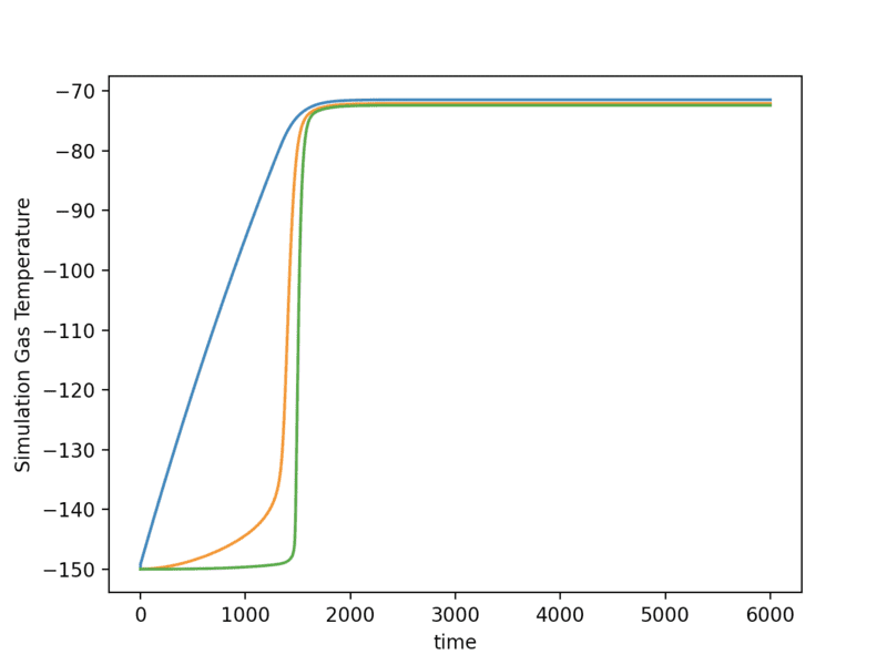

Maybe I've misunderstood again but this plot (Fig 7 in Tuinier) doesn't seem to make sense):
The x-axis is time in seconds and the temperature is the outlet temperature of the packed bed. Does this not say that their temperature reaches a maximum at roughly -90C also? But surely this is at odds with Fig 6 and 5 which show the temperature going above this. Or have I misunderstood? Because fig 7 looks a lot like our time vs Tg plot (besides the time scale)
  • #271
Those new graphs in #268 are encouraging to me. Some questions:
1. Why didn't you show temperatures from -90 to 100 C?
2. Although they use infinite U's and we use finite U's, our U's are still pretty high, as evidenced by the very small differences between the gas temperature and the bed temperature. What do our results look like using our correlations.
3. There seems to be a time scaling issue here. Are you sure you are showing the results at the correct times? Are you using fixed time interval, or having the integrator spit out results at specified times? The time scaling factor seems to be something like 10x.
It looks like the operating conditions for Fig.7 were a little different than for figs. 5 & 6. I wouldn't worry too much about this.
Because the temperature only rises to about -90C for some reason. I can run the simulation for much longer times but the temperature will max out at -90C

I think so anyway. So I pass t_eval to the integrator with is an array of times that I would like the solution stored at. I just store the time at each second interval. I also checked the length of the time array output by the integrator and it is the same length as the simulation time, surely indicating that there is no time scaling issue?
How can they not get higher than -90 C at short distances from the inlet? The stream coming in is at 100 C.

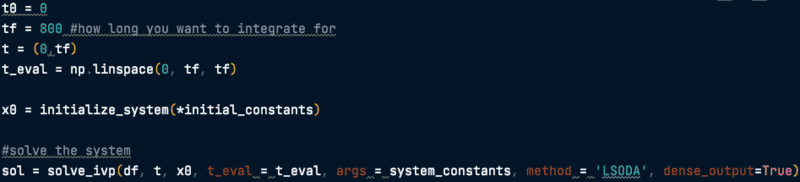

We seem to be losing a factor of 10 elsewhere then. It's hard to imagine where, unless it is the individual tank holdup time (molar holdup divided by molar flow rate).

Also I've implemented the variable ##U_g## values. They do change the plots slightly (not too much). Also printing out these ##U_g## values gives values in the range of about 20 to 60 W/m2.K
Here are the plots for non-constant ##U_g##:
Edit: I missed the molar flow rate question.
So the inlet flow is 0.0085mol/s. In the first tank this actually increases up to 0.01 mol/s and stays at about this value throughout the simulation. In the other tanks it also does an initial jump up to 0.01mol/s but then gradually tails off down to about 0.005 mol/s which is more what I would have expected, indicating I've possibly set this up incorrectly at the boundary

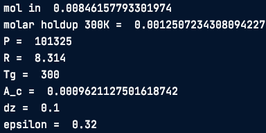

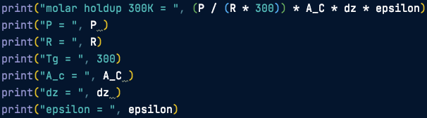

Heres the exact molar holdup calculation:
And here's the output:
Other values:
Bed length = 3m
Bed diameter = 0.035m
n = 30
dz = bed length/n
Possibly the most likely different value is the bed diameter. Are you also using 0.035m?

Their bed length is 0.3 m, not 3m.
  • #286
Whoops my mistake. I changed that and now yes I'm getting 0.00012 moles also for a single tank
Here are the plots with the correct bed length:
What I noticed was that this 'max levelling off temperature' of around -85C is not constant. If I zoom in:
The temperature at the inlet seems to actually slightly decrease over time
These plots are definitely quite a bit closer to the Tuinier plots though. The main things that are not the same are the temperature profiles near the inlet (not sure why the temperature doesn't increase further than -86C, and also possible the max mass deposition in our simulation being about double what is seen in Tuinier et al

Temperature plot for k=0, much closer to Tuinier et al again:
The temperatures near the inlet are now very close to the Tuinier values. We just don't have the constant temperature phase change section yet. Would we expect to have this though for k=0?
  • #289
Yes. This is about what I expected to see. The speed at which the profiles are advancing along the bed is on the order that I expected. How do the bed temperature profiles compare?

Those plots above are with ##U_g## being calculated (non-constant), and the values are between 20 and 50 W/m2.K. ##U_b## has a constant value of 20 W/m2.K. Here are the temperature profiles for gas and bed:
To get closer to the Tuinier simulation I'll change the U_b value to a very high number. The output temperature profiles with very high ##U_b## are below. The temperature increases faster (as expected) and the temperature profiles are more similar than with the smaller heat transfer coefficient:
Note: all of these plots are with ki = 0!

Why is the abscissa 0 to 29? Why isn't it 1 to 30? Also, let's plot the points at the coordinates of the center of the tank in cm: 0.5, 1.5, ...,29.5.
It seems like there is something wrong with the mass transfer description in the model. We seem to be getting much high heat releases from the desublimation than Tunier. Try scaling back the k's in the model until we get a better match with Tunier. Keep track of the scale down factor.

Thats just because I'm plotting from n=0 rather than n=1, its still 30 tanks but just shifted by one index. I should be able to change it but the output will be the same
To get these centre points I guess I should average adjacent points i.e.
$$T = \frac{T_j + T_{j-1}}{2}$$

No. you plot T1 and x=0.5 cm, T2 at x=1.5 cm, ..., T30 at x = 29.5 cm

  • #296
casualguitar said:
I turned the deposition rate off also. So now if the solid mass deposited goes below zero, both deposition rate and the amount deposited are set to zero. This did not change the plots. I think the reason the plots are unchanged is that the amount and rate are set to zero before ##\dot{m}_j## is actually calculated
Doing this currently (the scale down of ##k_i##)
k_i/100000:
ki/10000:
ki/1000:
ki/100:
Actually at ki/100 the gas temperature was still visually basically the same, however the bed temperature profile did start to show some hint of a constant temperature section:
  • #297
Just splitting these up as there is a memory limit:
ki/10:
Unusual behaviour here for the bed temperature.
So it seems like the real scaledown factor is somewhere between 10 and 100? I'm basing this on the max amount of solid deposited on the MCO2 plots. It does seem to be fairly close to 100 though. I'll post all of the ki/100 plots (Tg, Tb, MCO2)
  • #298
ki/100:
MCO2:
Zoomed in on the relevant section:
Tb:
Tg:
Note: the legend doesn't seem to show up on some plots. It is the same legend for all plots
  • #300
Chestermiller said:
Try k/30
k/30:
Here is a plot of the rate of desublimation of CO2 for the same selection of times:
The MCO2 plot seems to suggest that there are two plugs of CO2 moving through the bed rather than one. However the dM_CO2_dt plot doesn't suggest this
