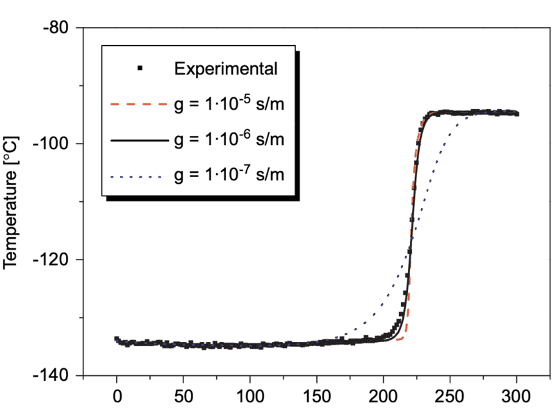

And the Tuinier et al equivalent:
So they are not that similar in that our one stops at -90C (around the desublimation temperature), and that there is no clear constant temperature section.

OK. I was confused. I missed the point that their total length of bed was 30 cm. However, the locations of their thermocouples do not necessarily correspond to the grid spacing in their model. I would suggest using more tanks in your calculations. Their graphs seem to suggest that the used a finer resolution than ##\Delta x = 3\ cm.##. I suggest 30 tanks, so that ##\Delta x = 1 \ cm## and so that the center of the first tank is at x = 0.5 cm and the center of the last tank is at 29.5 cm.
The locations where the temperatures are changing substantially in their model do not seem to correspond to where they are changing substantially in your model. All the variation seems to be happening closer to the inlet in your model. Is there a scaling problem on time?

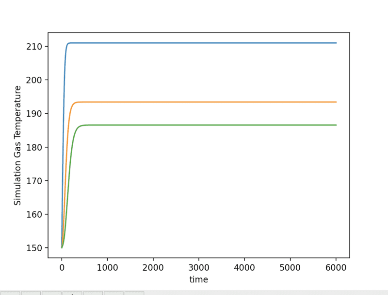

So the boundary condition equation is set up ok. This graph doesn't seem intuitive though (##T_{j-1}## - ##T_j## for all tanks). This delta T discrepancy is driving the higher rate of variation at the inlet:
Maybe one of the heat transfer terms driving heat transfer axially through the bed is low? The ##Q_GI## term at the inlet is much higher than ##Q_GI## for the other tanks also. I don't think this is to be expected.
I've checked the molar desublimation rates across the bed and they seem ok everywhere.
I messed around with the heat of vaporisations/desublimations just on the off chance they were incorrect. Currently the heat of desublimation and vaporisation are 26000 and 40650 J/mol respectively. If I just divide them both by 1000 (no particular reason other than maybe the current units are wrong), then the gas temperature levels off at a higher temperature. Still too low, but higher. Suggesting maybe that this is a value error rather than a desublimation mechanics error?
Plot of gas temperature with the heat of vaporisation/desublimation values divided by 1000:
Original values:

Slightly more interestingly, if I divide those heat of vaporisation/desublimation values by 1000 again then we get a relatively normal looking profile (note these temperatures are degrees C):
This might suggest that I haven't divided by 1000 somewhere where I should have. 1000 would come up when converting from kg to mol so maybe I haven't done that somewhere? Complete guess but will check

So the last two plots in post #261 show the temperature levelling off at a temperature that is below the inlet temperature (100C). I was pointing out in post #262 that if the heat of vaporisation/sublimation is multiplied by a factor of about 1000 then we get the correct 'temperature level off'. Obviously we can't just multiply by 1000 though so I thought maybe a factor of 1000 was missing somewhere else (possibly I hadn't converted between kg and mol properly somewhere). Just a thought though. But more importantly it shows that the desublimation/vaporisation mechanics aren't fully broken in that the gas temperature can go beyond the desublimation/vaporisation temperature

Maybe I've misunderstood again but this plot (Fig 7 in Tuinier) doesn't seem to make sense):
The x-axis is time in seconds and the temperature is the outlet temperature of the packed bed. Does this not say that their temperature reaches a maximum at roughly -90C also? But surely this is at odds with Fig 6 and 5 which show the temperature going above this. Or have I misunderstood? Because fig 7 looks a lot like our time vs Tg plot (besides the time scale)
It looks like the operating conditions for Fig.7 were a little different than for figs. 5 & 6. I wouldn't worry too much about this.

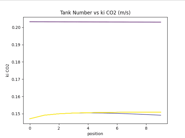

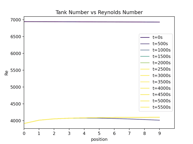

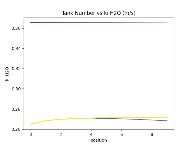

I was about to comment in relation to this. Printing the reynolds numbers at each position results in values around Re = 100, which are possibly quite low
For a molar flux of 0.27kg/m2.s as used in Tuinier et al, I get a molar flow of 0.0085mol/s, which gives a gas holdup of 0.0012 mol at a temperature of 300K and 1 atm. Does this seem reasonable?

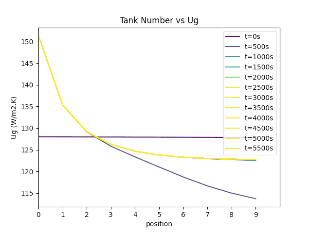

Also I've implemented the variable ##U_g## values. They do change the plots slightly (not too much). Also printing out these ##U_g## values gives values in the range of about 20 to 60 W/m2.K
Here are the plots for non-constant ##U_g##:
Edit: I missed the molar flow rate question.
So the inlet flow is 0.0085mol/s. In the first tank this actually increases up to 0.01 mol/s and stays at about this value throughout the simulation. In the other tanks it also does an initial jump up to 0.01mol/s but then gradually tails off down to about 0.005 mol/s which is more what I would have expected, indicating I've possibly set this up incorrectly at the boundary
