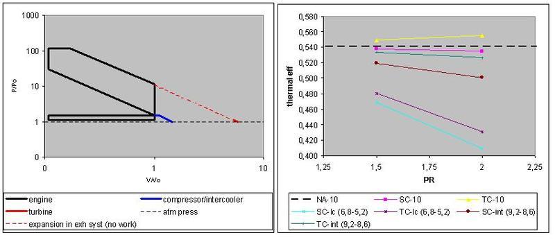

Btw, there was a typo in my previous post. I meant to say that at constant speed the mpg is HIGHER on a small engine with a turbo.
  • #43
Also, the wiki on turbochargers clearly explains why a supercharger decreases efficiency while a turbo increases it: the super uses otherwise usable shaft energy to spin the compressor while the turbo uses otherwise wasted exhaust energy.
Also note that a gas turbine engine is much more efficient than an Otto or diesel and is basically just a tubocharger operaing on its own.
  • #44
Not so. This is a very, very common misconception. A turbocharger restricts exhaust to get energy to pressurize the intake.
Exhaust brakes also restrict exhaust. Would you say exhaust brakes also use "otherwise wasted exhaust energy" since using them clearly does nothing in particular but has a retarding effect on the engine, by making it pump against, what is for it, essentially, a pressure gradient?
Another very common misconception is that turbochargers are powered, at least in part, by exhaust gas temperatures, again suggesting turbochargers have low or no parasitic losses.
You can't extract useful mechanical work directly from thermal agitation.
What you can do is contain the expansion of a working fluid under heating to increase pressure. Then extract useful mechanical work from the pressure gradient between the contained working fluid and the environment or a condenser, in the case of an external combustion engine.
So we're back to where we started. Boost isn't free as running on it increases backpressure, making the engine pump against, what is to it, a pressure gradient.
Or... the marginal increase in fuel consumption under boost is greater than the marginal increase in torque at a given rpm.

Small capacity turboed is more efficient for mostly low load applications.
When you're not running on boost, yes.
Forced induction is not a free lunch.
Big capacity aspirated is better for mostly high load applications (near peak power most of the time and tracing the torque graph when not).
When you'd be running on boost and at higher rpm if you had a small displacement turboed engine, yes.
Turbocharging, not just supercharging, also saps efficiency by increasing pumping losses through extra back pressure.
I've already backed this up. See comparisons with exhaust brakes and other restrictions, like catalytic converters, particulate traps, etc.
Why do people seem to think that pumping against a pressure gradient doesn't require energy.
Turbocharging degrades specific fuel consumption.
Everybody seems to agree that supercharging increases fuel consumption / power but turbocharging is believed to be a free lunch.
Why not fit the biggest turbo you can find to a 1.2 tdi and see how that helps specific fuel consumption at WOT.
You may be getting more power but you pay for it in higher BSFC.
See above. Even http://en.wikipedia.org/wiki/Turbocharger#Comparison_to_supercharging" that the marginal increase in power is less than the marginal increase in fuel consumption, with supercharging. Yet this is in the context of turbocharging being a free lunch in comparison, you see.
In reality, you are still getting the energy needed to pressurize the intake from the engine. It's just that you get it differently. Instead of a mechanical coupling (belt, pulleys) you use fluid coupling (turbo in the exhaust stream, an obstruction which increases backpressure which takes torque away from the engine on the exhaust stroke).
A far leaner and flexible system, which scales boost with load as needed instead of scaling with engine rpm and requiring a gearbox or a bypass and/or overboost release valve.
But you still have to burn more fuel for the same amount of power you generate under WOT than a bigger, naturally aspirated engine of the same compression ratio would make without boost.
And most likely need to rev higher as well, opening another can of worms with reciprocating mass inertial losses and pumping losses, which exhibit squared growth with engine rpm.
The higher the boost you're running, the more efficiency drops.
Yup. Because more energy is required to maintain higher boost. Energy that isn't going, more or less, directly into propelling the vehicle but simply pumping more air into the cylinders on the intake stroke.
the way the intake and exhaust manifolds are shaped isn't conducive to the best airflow.
Yup. Have you seen the exhaust manifold on an Opel Zafira 2.2 cdti? It's a T-pipe. Like something right out of the 1920s. Haut couture on a model T.
{Two stroke engines}can't run without supercharging. They are often turbocharged as well because they suxorz so bad with power.
That's not an accurate quote. I was talking about marine & industrial app. two stroke diesels.
They aren't self charged for intake and cylinder scavenging as they can't run the intake charge through the crankcase because of the risk of a runaway on oil fumes. Being compression ignition engines and all.
Without supercharging they wouldn't run at all. Sometimes they are turbocharged in addition to supercharging.
You may also need to run richer.
In a turbo petrol application, yes. You may also need to retard ignition advance to the point that much of the power gain is lost.
Turbocharging doesn't increase efficiency. It increases BSFC across the load range.
Aye. Even when not running boost, the compressor's impeller and turbo are just another impediment to pumping air through the engine and back out to the atmosphere as easily as possible.
The turbo is just another obstruction laying around in the exhaust stream close to the engine and the intake and exhaust manifolds are often rudimentary, cast iron for exhaust and aluminum for intake, with no great care having been taken in the design of the runners to optimise flow as would be the case with decent NA petrol engines. Most turbodiesel 4 cyls. are 2 valves per cyl. as well.
Now it might not be a significant difference but still.
See above.
xxChrisxx said:
EDIT: Also he keeps banging on about how it increases BSFC across the range... well of course it does. They are making more power across the entire range, with more power being made you'd expect more fuel to be burnt.
Note that BSFC is rate at which fuel is being consumed over the power produced.

I did some calculations to raise the level of the discussion.
I compared simple P-V diagrams to find out the thermal efficiency (no friction losses) of different engine configurations. Thermal eff is directly linked to BSFC.
The reference NA engine has CR = 10:1, an inlet temperature (Tin) = 288 K and the temp at the end of the compression stroke (Tcomp) = 645 K.
Then I compared SC and TC engines with the same CR at a PR of 1.5 and 2 (7.35 psi & 14.7 psi boost), Tin becomes 330 K and Tcomp = 738 K.
The previous might be good for CI, but for SI - if we assume the NA engine is at the knocking limit of the fuel - we have to adjust the CR of the SC & TC engines to get Tcomp = 645 K. The new CR was 6.8 for PR = 1.5 and 5.2 for PR = 2.
If we put an 80% efficient intercooler after the compressor, we can raise the CR to 9.2 for PR= 1.5 (8.6 for PR = 2) without going over Tcomp = 645 K.
On the picture, I have put an example of the simplified P-V diagram (log-log) for a TC intercooled engine and the results for the thermal efficiencies.
I think I didn't make any mistakes.
With a SC, eff goes down, no matter what. The higher the PR, the lower the eff.
With a TC, the eff goes up with PR, only if we keep the same CR. As soon as we lower the CR, eff goes down just like the SC engine, while being slightly higher.
With a low PR, a TC and an intercooler, the losses are minimal.
What do you think?
  • #56
Blimey Jack you are keen as mustard. All the numbers you came up with look about right (I know they were all assumed but it's surprising how close they are to real engines).
The VW 1.8 20V engine in the Golf Gti comes in a TC and non TC.
Non TC - 125BHP output CR - 10.5:1. Peaky engine.
TC intercooled - 150BHP CR - about 9.3:1 iirc. Nice flat torque curve. (the one I've got :D)
So those numbers are pretty damn close. I don't think they can be argued with.
  • #57
The problem with using data from real engines (especially when they come from publicity) is that they don't always give the full picture. For example, a manufacturer could build a sport car by putting a turbo on an engine from their family car, but if you read the owner's manual, you find out that it also run on 92 octane instead of 87, alloying a higher compression ratio, thus higher efficiency. In such a case, comparing both engines becomes pointless.
We can argue forever by always finding an engine that contradicts or supports whatever we want when we only look at what serves our purpose.
Thermodynamic seems to be a very useful tool in such a discussion. After all, it's a physics forum :biggrin:.
